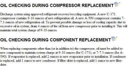

I am replacing the compressor, accumulator, and the dryer all with new parts. How much reefer oil should I ad to the system when I charge it?

https://images.2carpros.com/forum/automotive_pictures/261618_Noname_2084.jpg
