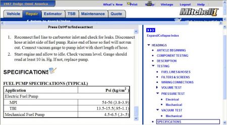

what should the fuel pressure range for a stock 2.2 engine be

See chart below
