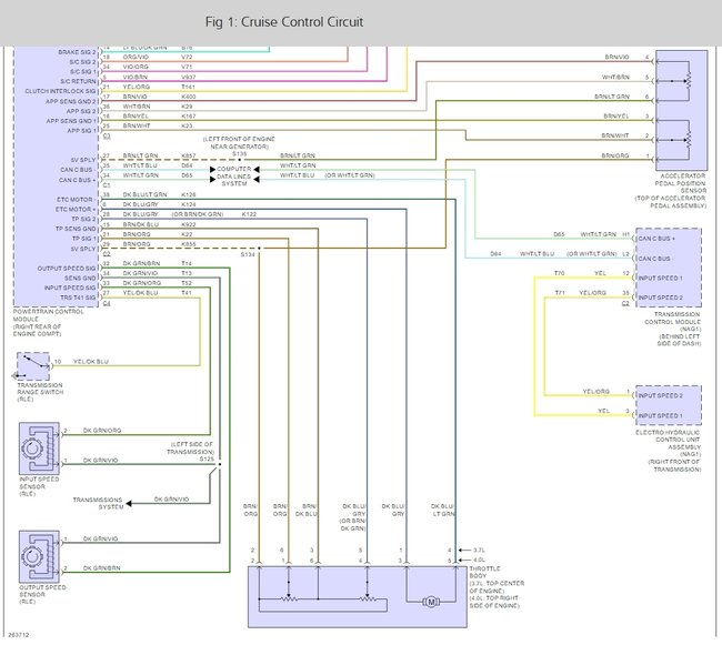

CRUISE CONTROL NOT WORKING
2007 DODGE NITRO
48,000 MILES • 6 CYL • 4WD • AUTOMATIC
CRAIG FARON
Is there a relay or fuse for the cruise control and where is it located?

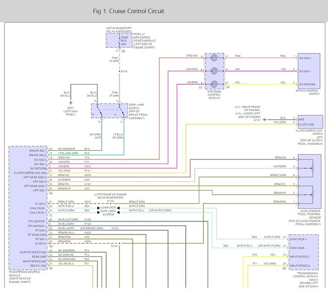

Hey CRAIG,
The fuse is M15 in the integrated controller which is under the hood, here is a wiring diagram to help show the fuse and other wiring so you can troubleshoot the problem and a guide to help test the fuse. There is no relay I have seen the steering wheel clock spring cause this issue.
Please run some tests and get back to us so we can continue helping you.
Best, Ken
