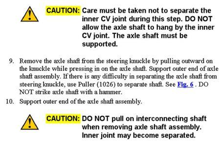

I don't like to spread paranoia, but your last paragraph may be quite accurate.
https://images.2carpros.com/forum/automotive_pictures/30961_axshft_1.jpg
As you can see, there is great care needing to be taken when doing wheel bearings.

Yeah, that's exactly why I was worried about it. I have the service manual and saw that in there.
