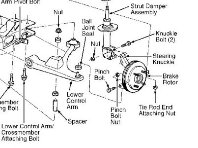

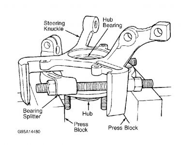

Hi! I need some info on how to change the front wheel bearing.Is it a sealed unit as in the hub and bearing are one unit?Is it a pessed in bearing?Do you replace the hub and bearing?If you could send me the any info it would be awesome.Thanks
May 9, 2007 at 7:07 PM
SERVICE WRITER
  • 9,123 POSTS
You'll need to pull the steering knuckle and have it pressed out. You may want to pick up a manual for the replacement procedure.
https://images.2carpros.com/forum/automotive_pictures/30961_wb1_1.jpg
https://images.2carpros.com/forum/automotive_pictures/30961_wb2_1.jpg
