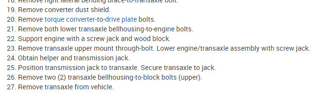

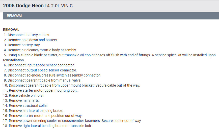

My daughter was driving her car and lost power and started jerking. I thought it was the transmission so I added a quart and it drove just fine. The next day after driving for about and hour it done the same thing. They tell me I need to replace the transmission can you help me please?

Here is a tutorial showing what is involved for transmission removal and replacement. Although this is for a manual transmission it is similar.
https://www.2carpros.com/articles/transmission-replacement-removal-manual
this video can help as well
https://youtu.be/6N6b5F2ChyE
I've attached picture steps below for transmission removal and replacement below for your vehicle. Hope this helps and thanks for using 2CarPros.
