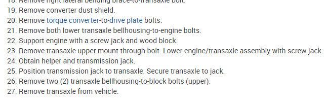

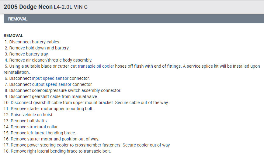

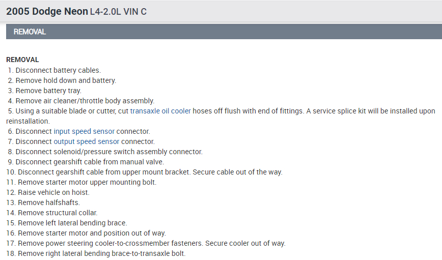

I've attached picture steps below for transmission removal and replacement below for your vehicle. Hope this helps and thanks for using 2CarPros.
