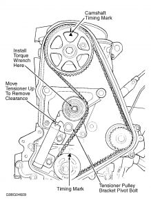

Hy! I own a 2005 dodge neon sxt and just recently my dad, while it was raining he tried to go over a wash and the car stalled. the next morning the car turned on fine and 2days later the "CHECK ENGINE" light turned on. We might think that while the water might have done the damage it could affected the timing belt and water could of caused it to slip on the timing. anyways im trying to fix the problem by trying to find the TIMING MARK on the pulley itself but i cant find it. WHERE CAN I FIND THE TIMING MARK??? PLS HELP

checking and changing the timing belt is not a bad idea at this mileage I don't think its the cause for the check engine light u need to get the codes u can do that by cycling the ignition key on off three times ending with key in the on position read codes in the odometer area (P # ## #)

REPLY: thanks for your help i really appreciate it. The codes that come up are P0068 and P2074 and probable causes are 1) Check Engine for vacumm leak. 2) Check Engine condition and/or mechanical condition**Plugged exhaust or intake. 3) Trasnmission condition*this is why i asked about the timing*) If you have any advice pls let me know Thanks!!!
