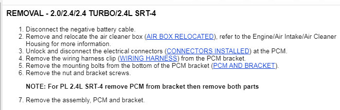

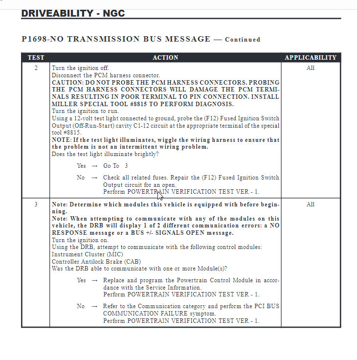

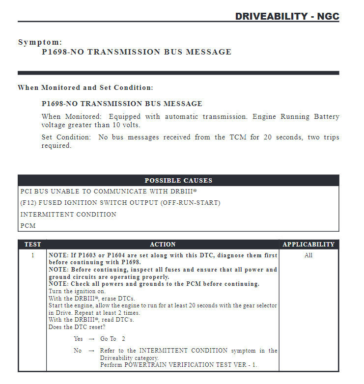

BRITTANY NELSON
Where is the tcm located on a 03 dodge neon I have a code of p1698
Dec 3, 2019 at 8:52 AM

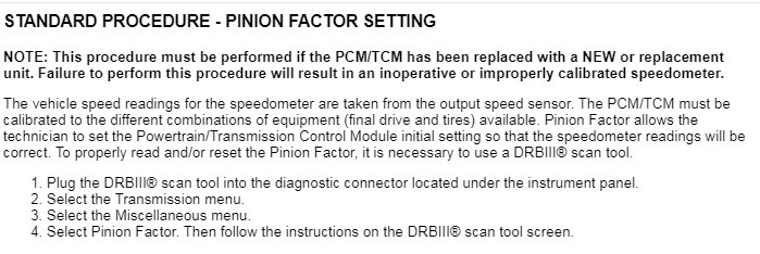

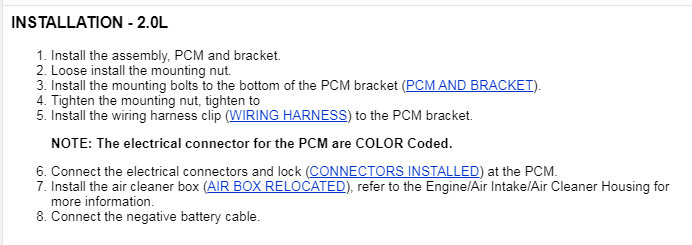

This vehicle does not have a specific TCM. It is part of the PCM. I attached the detail for this code. If you have further questions, let's get a new post started with your specific vehicle and issue so we can be sure to assist properly.
