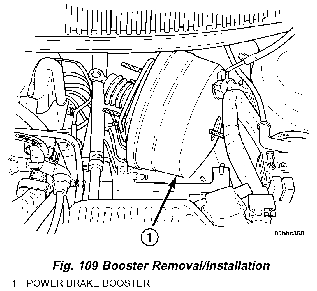

It has just recently snowed and I haven't driven my car in a couple of days. I just replaced the battery and I noticed my brake pedal was extremely stiff. I had to push on it as hard as I could to get it to stop. I refilled the brake fluid but it still has not changed I need a booster.

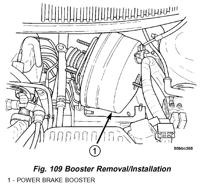

Replacing a power brake booster takes a little time, but really isn't too hard to do. I recommend getting a lifetime replacement part so you never have to pay for a new one in the future.
Here are the directions specific to your vehicle. The pics attached below correlate with the directions.

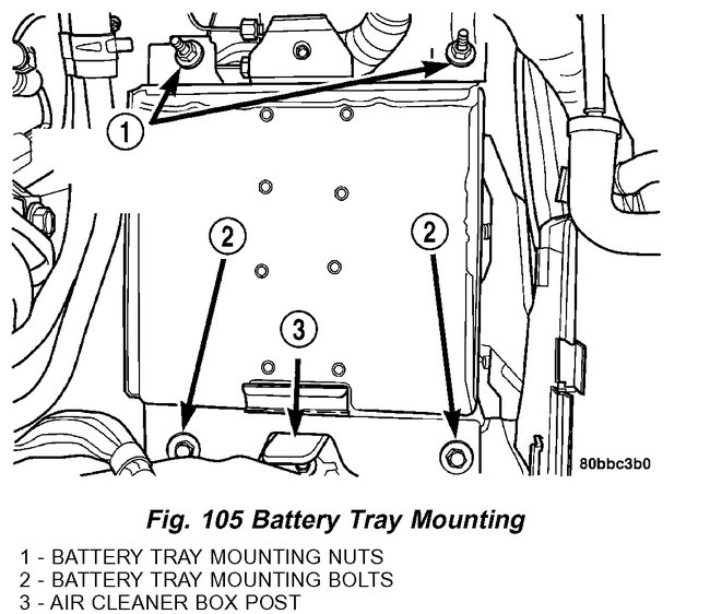

2. Disconnect the positive cable from the battery, then remove the battery from the battery tray. There is one nut securing the clamp on the backside of the battery holding it in place.
3. Remove the one nut and one bolt securing the air cleaner box in place, then disconnect the wiring harness connector at the air inlet sensor.
pic 1

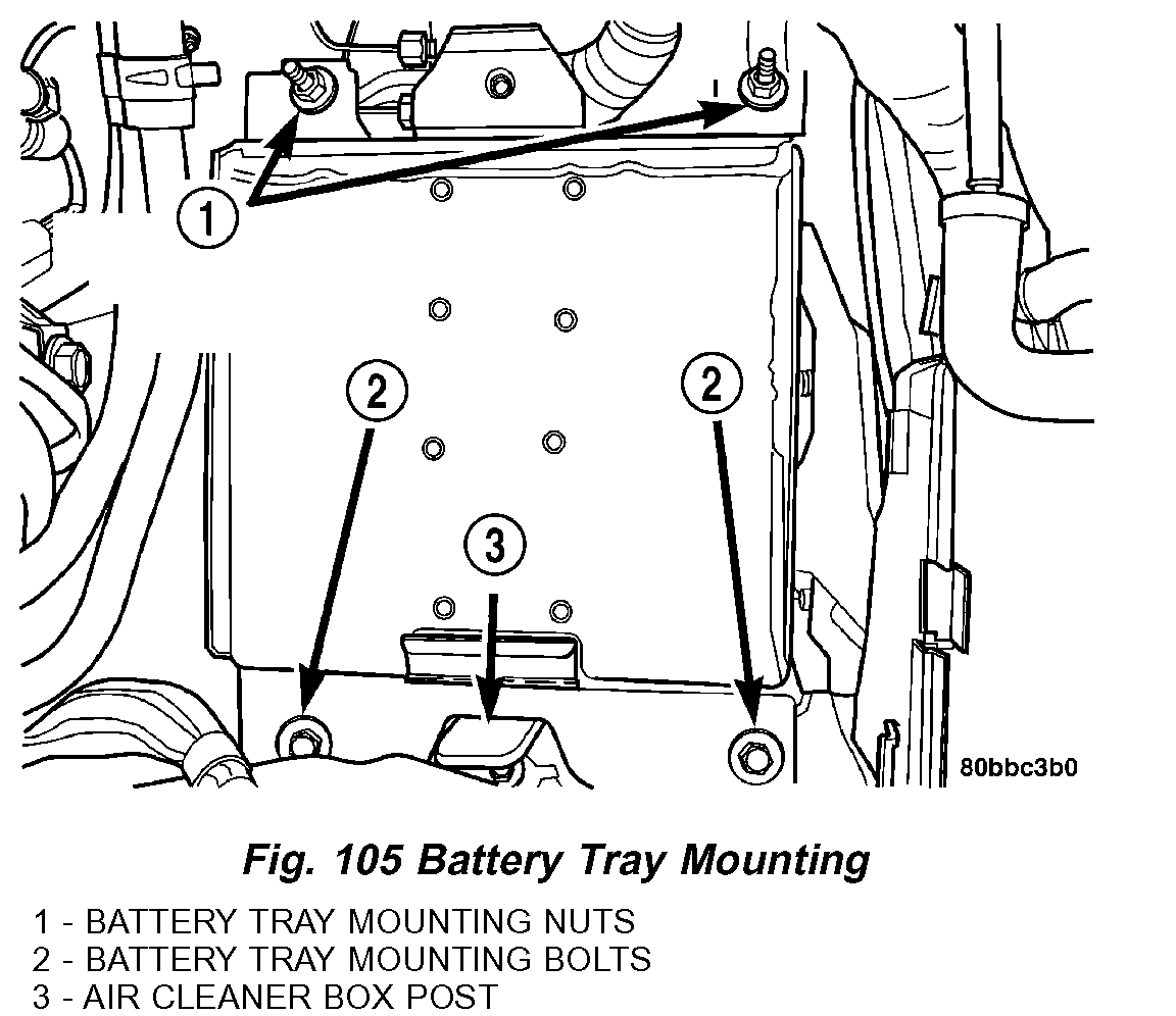

4. Lift the air cleaner box upward enough to clear its grommeted alignment post (Fig. 105), then move the air cleaner box forward just enough to access the battery tray mounting bolts.
5. Remove the 2 bolts, then the 2 nuts mounting the battery tray to its bracket (Fig. 105). Remove the battery tray.

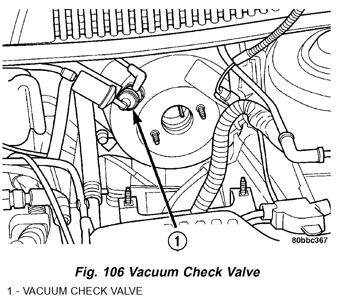

9. Disconnect the vacuum hoses from the check valve on the power brake booster (Fig. 106), but do not remove the check valve from power brake booster.

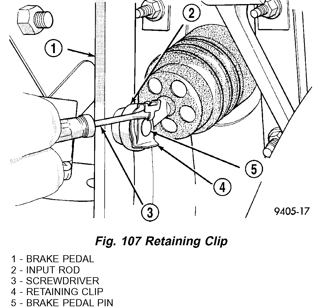

10. Locate the brake pedal-to-power brake booster input rod attachment under the instrument panel. Position a small screwdriver (Fig. 107) under the center tang of the retaining clip. Rotate the screwdriver enough to allow the retaining clip tang to pass over the end of the brake pedal pin. Remove the clip.
CAUTION: Discard the used retaining clip, it is not to be reused. Replace the clip with a new one on reassembly.

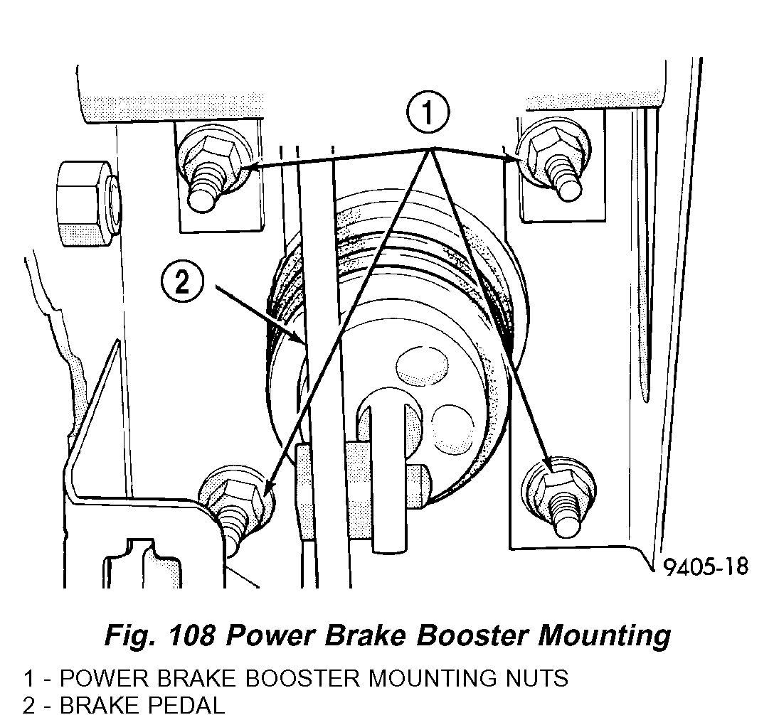

11. Remove the four nuts attaching the power brake booster to the instrument panel (Fig. 108). The nuts are accessible from under the instrument panel in the area of the brake pedal bracket.

12. Slide the power brake booster forward until mounting studs clear the instrument panel. Turn the booster sideways (Fig. 109), then remove it from the vehicle.
INSTALLATION - LHD
1. Turn the power brake booster sideways (Fig. 109), then install it into the engine compartment down past the heater hoses and the strut tower. Rotate the booster so its four mounting studs and input rod are pointed straight toward the instrument panel. Slide the input rod and studs through the instrument panel and into mounting position.
2. Under the instrument panel, install the four power brake booster mounting nuts (Fig. 108). Tighten the nuts to a torque of 34 Nm (25 ft. lbs.).
3. Using lubricate, or an equivalent, coat the surface of the brake pedal pin where it contacts the brake booster input rod.
CAUTION: Use only a new brake booster input rod-to-brake pedal retaining clip to ensure proper retainment. Install a new brake lamp switch anytime the old switch is removed, the brake booster or pedals have been changed or removed.
4. Connect the power brake booster input rod-to-brake pedal pin. Install a new retaining clip. Do not use the old clip.

6. Connect all previously removed vacuum hoses to the vacuum check valve (Fig. 106).

10. Position the battery tray back in place. Install the two bolts, then the two nuts mounting the battery tray to its bracket (Fig. 105). Tighten the two bolts and nuts to a torque of 34 Nm (25 ft. lbs.).
11. Reinstall the air cleaner box onto its grommeted alignment post (Fig. 105).
