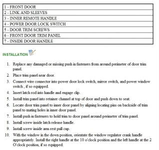

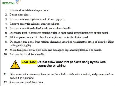

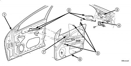

My door won't open all the way. It only opens about 1 to 2 inches. It's like something is catching it. During the winter, I had snow on the side window door so I opened it a little then shut it to clean it off. The door hasn't opened ever since. It's got a bouncy feel to the door when trying to pull it open. However, I'm afraid to really pull forcing it open. I'd like to remove the door panel to see what is stopping it from opening all the way. Any suggestions?
