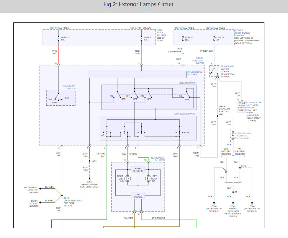

my brake lights wont come on?

This sounds like the brake light switch or a fuse is out these guides can help us fix it. The fuse location for your can are in the diagrams below.
https://www.2carpros.com/articles/brake-lights-not-working
and
and

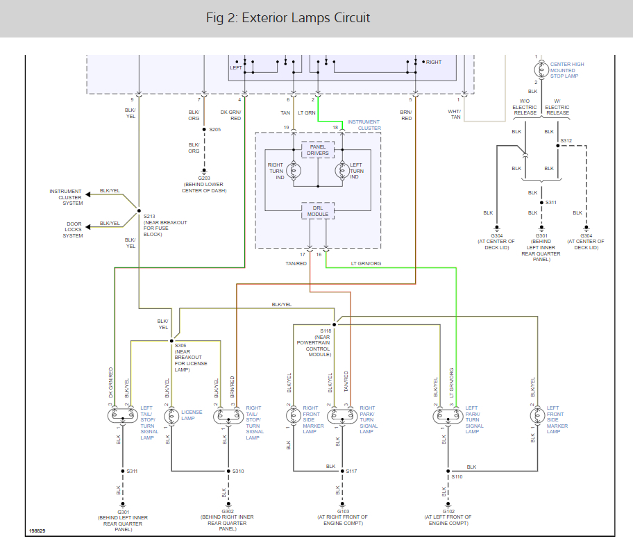

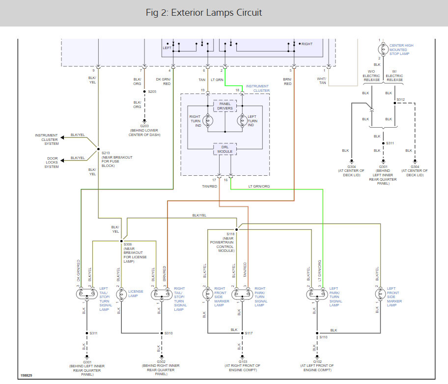

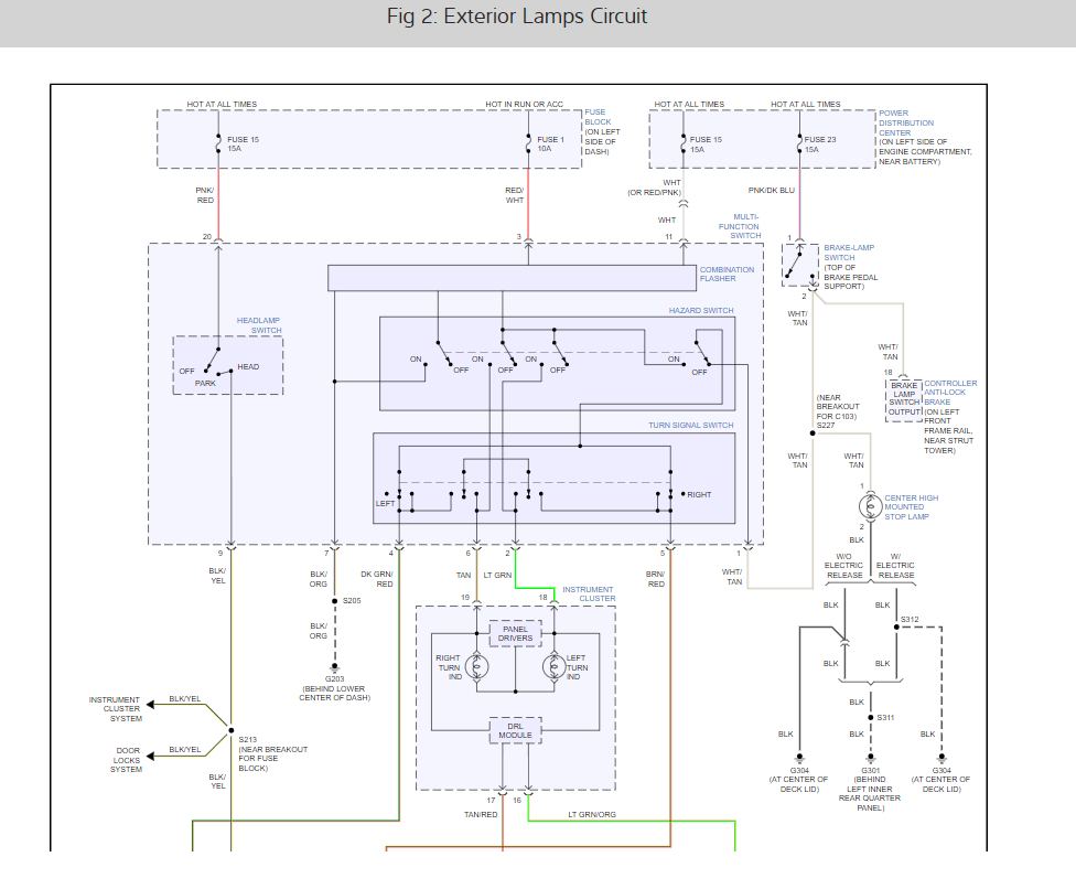

Here are the brake light wiring diagrams so you can see how the system works. If you have replaced the fuse (circled), ext check to make sure all bulbs (including the center brake lamp) are good, then check the brake switch, above the brake pedal support. Check out the diagrams (Below). Let us know what happens and please upload pictures or videos of the problem.
