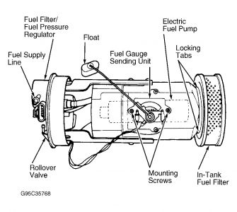

Fuel filter location so I can replace it?
2005 DODGE NEON
KHETOMAN
Where is the fuel filter located in my vehicle?
[img:c5d9199c9e]http://www.2carpros.com/forum/automotive_pictures/161427_c445083a_1.jpg[/img:c5d9199c9e]
I need to replace it

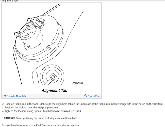

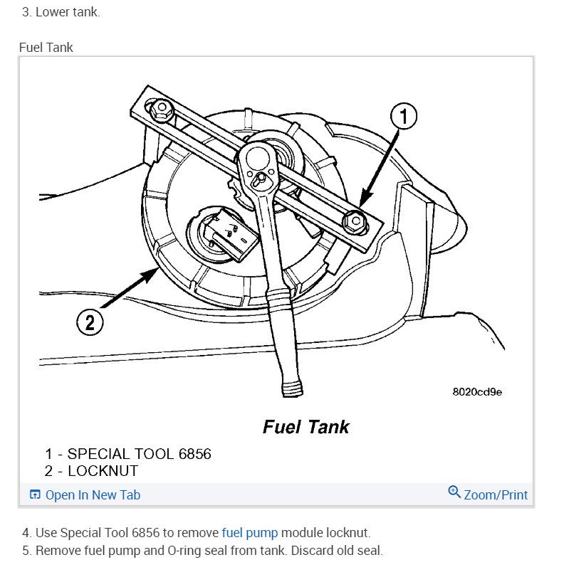

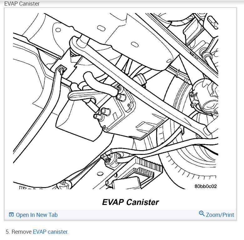

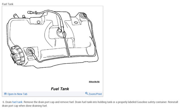

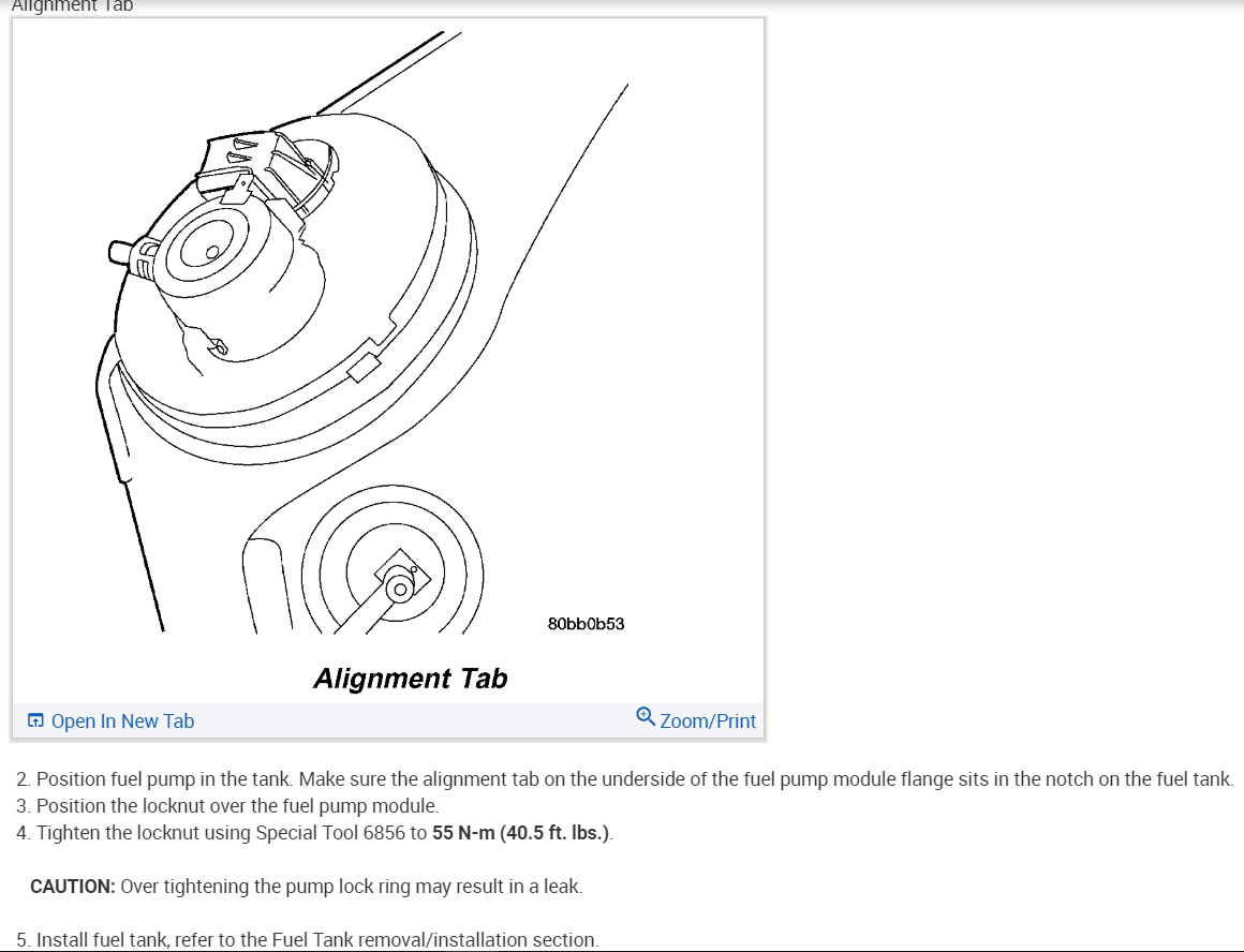

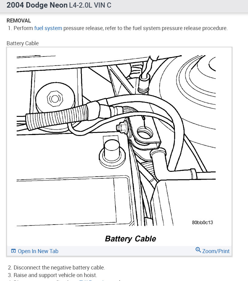

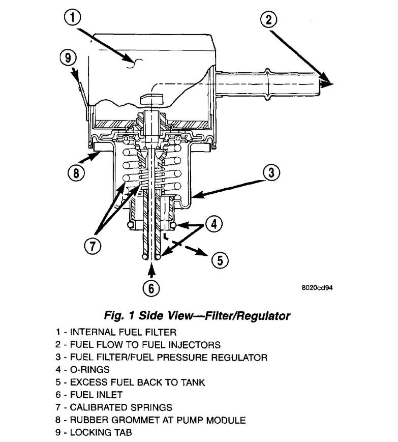

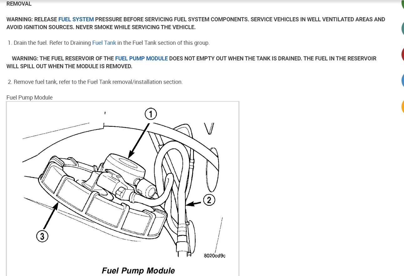

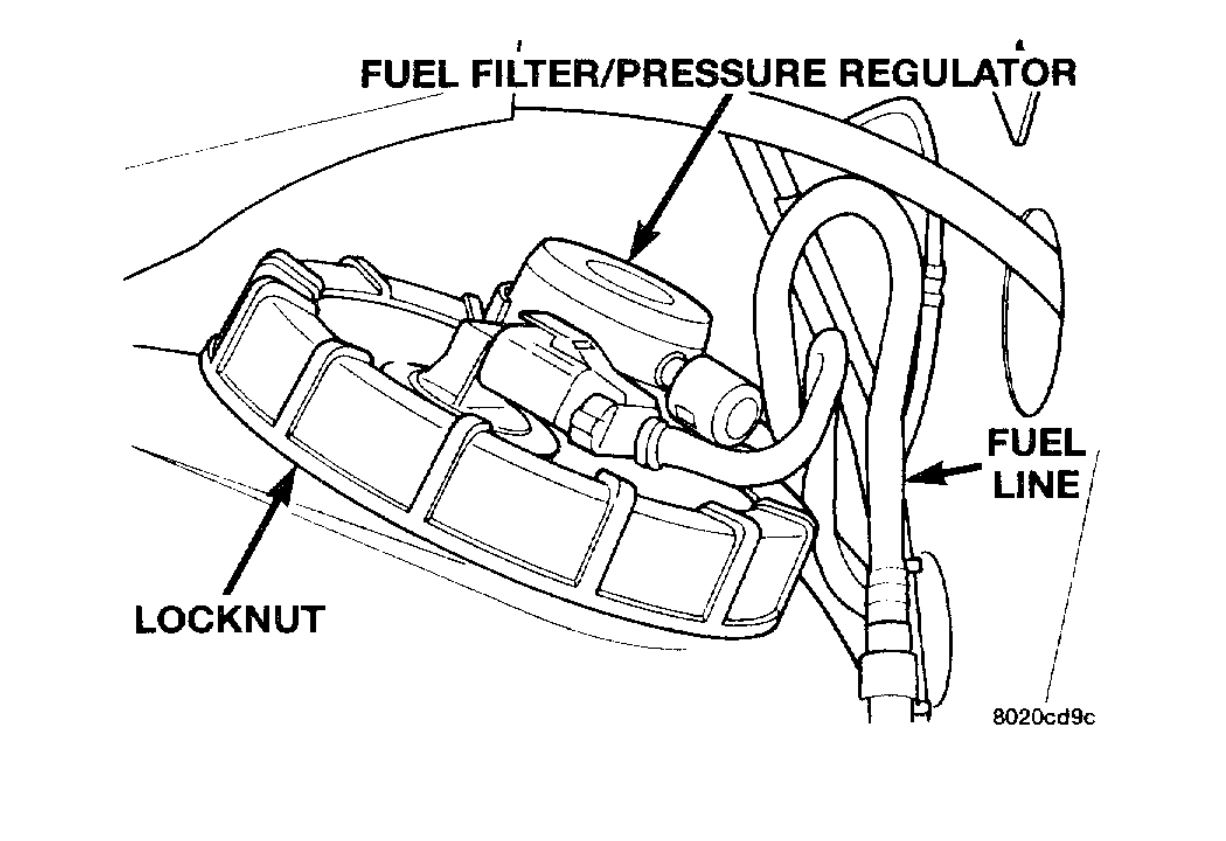

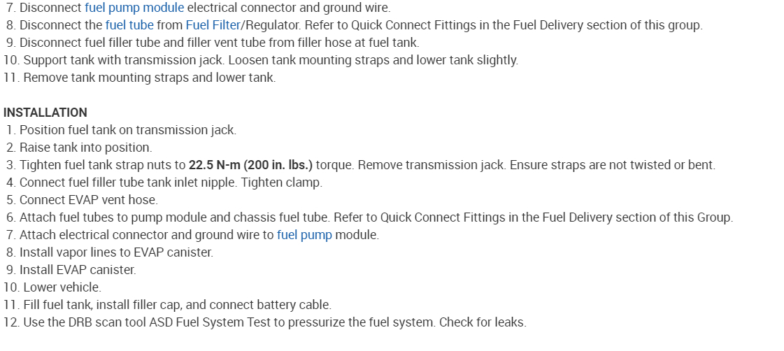

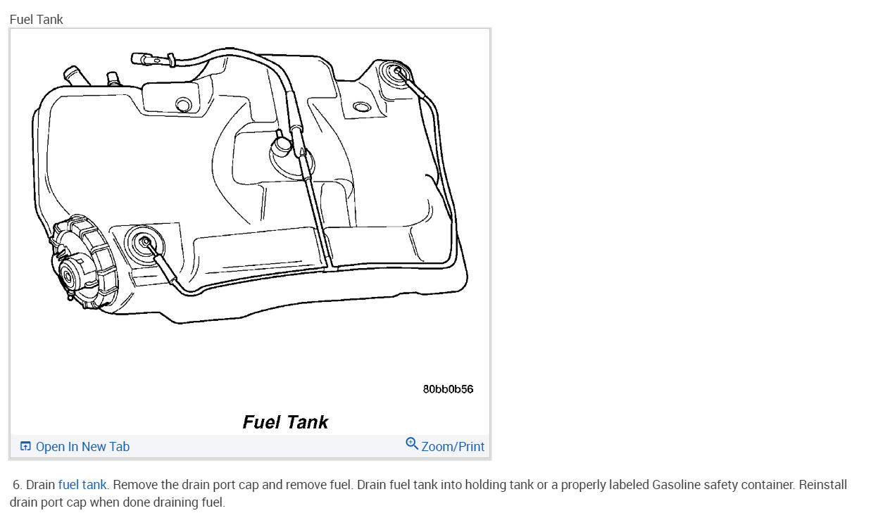

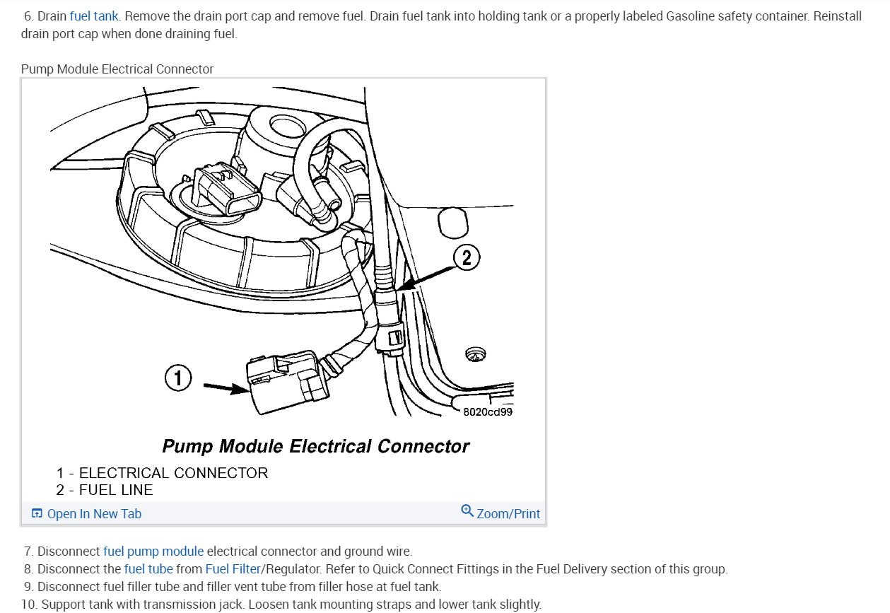

The only filter in your car is in the fuel tank, and is only replaceable as part of the pump module. Here is a guide to help you see what's going on and how to replace the filter and pump module with instructions in the diagrams below to help you you your car.
https://www.2carpros.com/articles/how-to-change-a-fuel-filter

My son's car was sputtering and shaking then it will turn over but not start. I know he runs it low on fuel a lot so I think it might be the fuel filter. Where is it at on this car and how do I change it?

Your gonna love this, It is on top of the fuel tank and is part of the pressure regulator. The fuel tank has to come out of the vehicle to replace it. Sorry
See the images below

Where is the fuel filter at on a 1996 Dodge Neon and how to replace it?

the filter is mounted on the pump inside the fuel
https://images.2carpros.com/forum/automotive_pictures/266999_neon_1.jpg
tank

i need detailed instructions and tools needed to change fuel filter in dodge neon

The filter is in the tank with the fuel pump.
