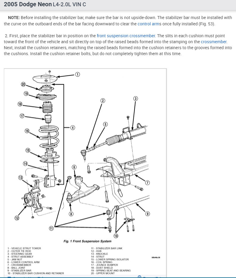

I purchased a used dodge neon and notice when making left hand turns the entire car slides to the right. The car responds normal when making right hand turns. I believe it's the tires. Any other idea?
May 5, 2010 at 6:42 PM
SQM
  • 6,383 POSTS

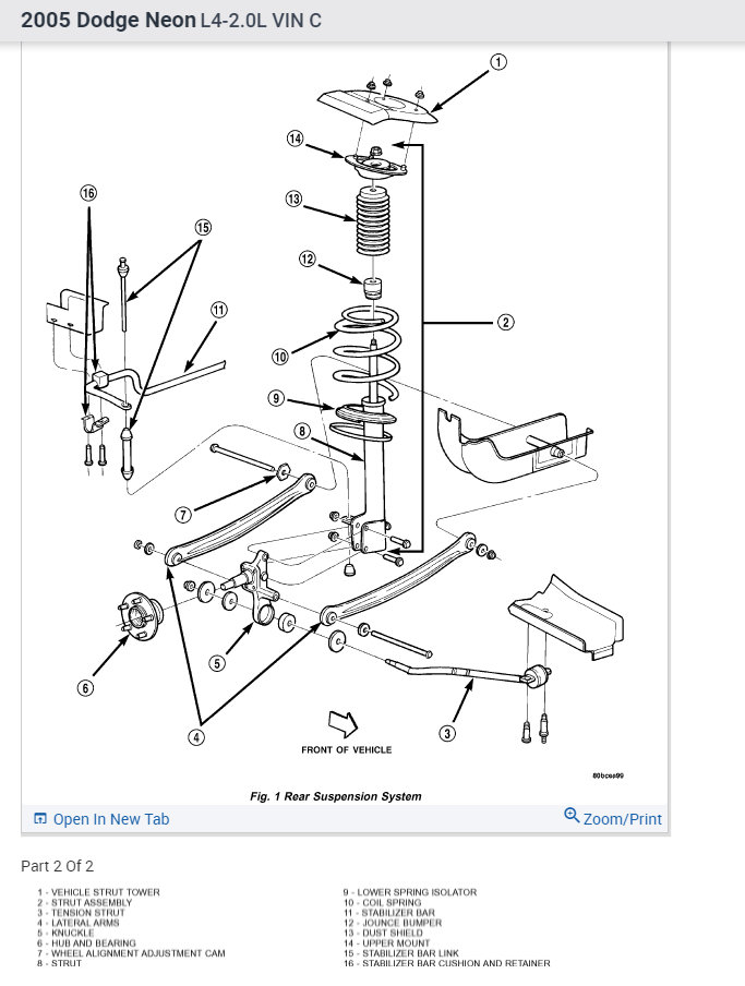

If the vehicle skids across the pavement, it could be bald/worn out tires.
https://www.2carpros.com/articles/how-car-tires-work

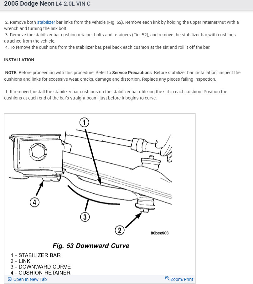

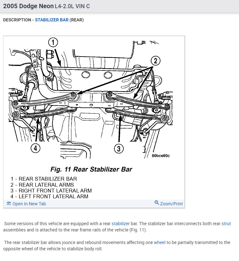

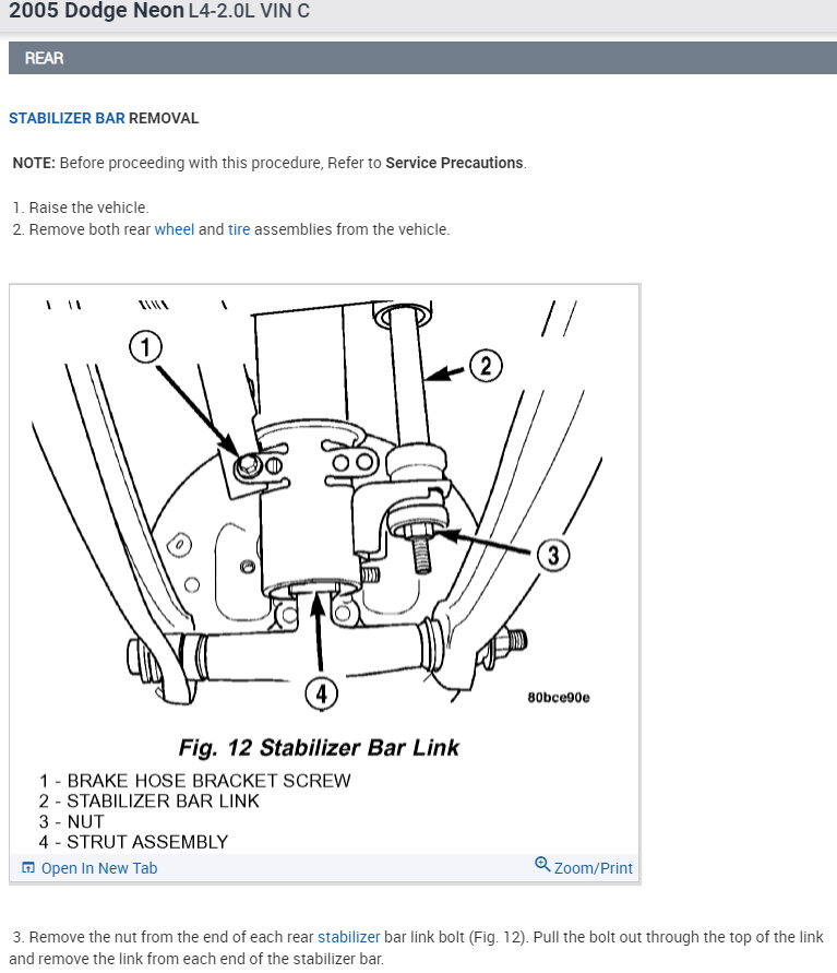

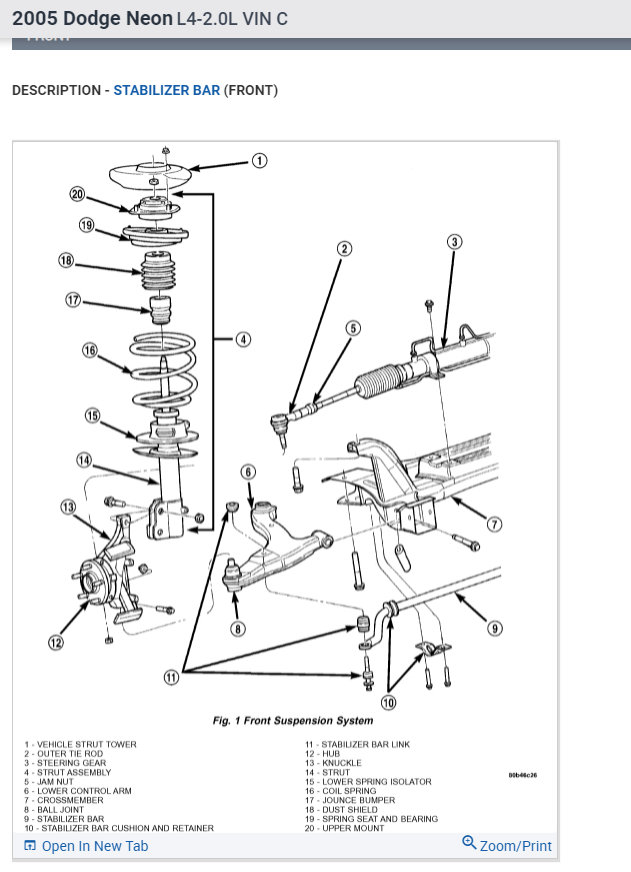

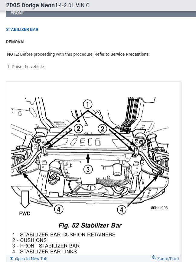

But if it just leans excessively, it could be due to faulty sway bar or sway bar links.
It will be a good idea to inspect those components, especially on the right side.
Are you getting any type of noise?
Look for any broken links/bars or loose/worn bushings.
https://www.2carpros.com/articles/popping-noise
I have attached diagrams showing the location and replacement procedure below.
