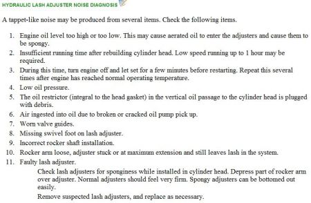

When i start my car on a cold morning it makes slaping noises from the top part of the engine.When it's hot out it does not make that loud noise. What do you think can be doing this and can it be repaired or is there nothing to worry obout.

https://images.2carpros.com/forum/automotive_pictures/55316_05neonlifter_1.jpg
