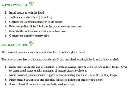

how do you install a camshaft sensor on this model?

https://images.2carpros.com/forum/automotive_pictures/261618_Noname_1802.jpg
https://images.2carpros.com/forum/automotive_pictures/261618_Noname2_575.jpg
https://images.2carpros.com/forum/automotive_pictures/261618_Noname3_222.jpg
