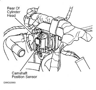

Yes it is possible that the crank sensor is doing it. Sometimes if the PCM sees a bad correlation between the two, it will give a code that is a little off track.Also sounds liek you may have a bad neutral safety switch, or trans position sensor, which ever they are calling it on your car
Here is how to change the sensor out with diagrams below to show you on your car.

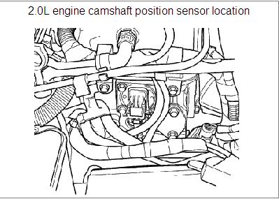

Sunday, I was on my way home from church when the car started jer4king as though it wasn't getting enough gas. The check engine light was on so I took it to AutoZone and they ran a diagnostics check. They said it is my cam sensor. They did not have the part in stock, so I ordered it and am waiting for it to arrive. I would like to know where the cam sensor is located and what I need to do to replace it. Your help would be greatly appreciated. Thank you in advance.
Dec 7, 2020 at 11:36 PM (Merged)
JDL
  • 16,098 POSTS
Hello, not sure of engine litre size? The sensor may be located driverside end of cylinder head.

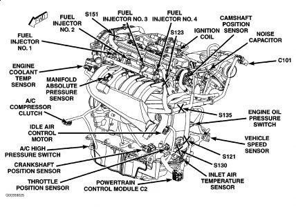

where is the cam sensor
Dec 9, 2020 at 12:23 AM (Merged)
OBXAUTOMEDIC
  • 3,711 POSTS
Hi Chris, It should be located at the rear of the head....

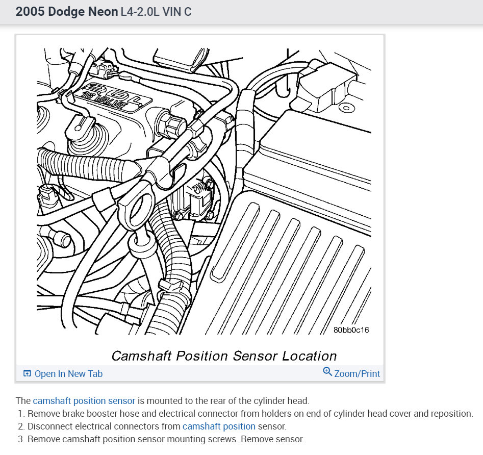

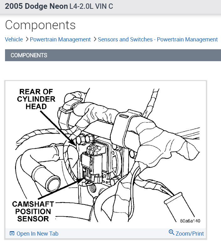

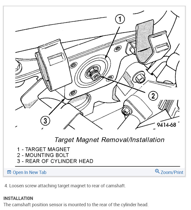

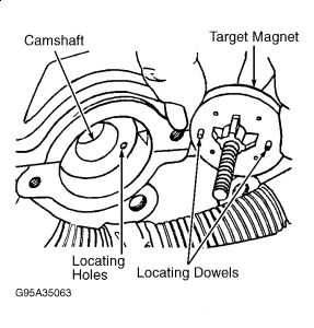

Where is the cam shaft censor on this car and how would i replace it?

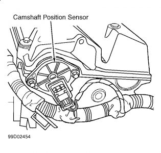

Dec 9, 2020 at 12:24 AM (Merged)
  • 75,992 POSTS
Camshaft Position Sensor
https://images.2carpros.com/forum/automotive_pictures/12900_cm_1.gif
The camshaft position sensor is mounted to the rear of the cylinder head. 1.Remove brake booster hose and electrical connector from holders on end of cylinder head cover and reposition. 2.Disconnect electrical connectors from camshaft position sensor. 3.Remove camshaft position sensor mounting screws. 4.Remove sensor. 5.Loosen screw attaching target magnet to rear of camshaft. INSTALLATI0N The target magnet has two locating dowels that fit into machined locating holes in end of the camshaft. 1.Install target magnet in end of camshaft. Tighten mounting screw to 3.4 Nm (30 in. lbs.) torque. Over torquing could cause cracks in magnet. If magnet cracks replace it. 2.Install camshaft position sensor. Tighten sensor mounting screws to 9 Nm (80 in. lbs. ) torque. 3.Place brake booster hose and electrical harness in holders on end of valve cover. 4.Attach electrical connectors to camshaft position sensor. https://www.2carpros.com/kpages/auto_repair_manuals_alldata.htm

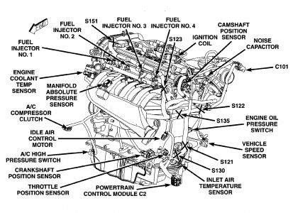

where does the camshaft position sensor go on the car.
BMRFIXIT
  • 19,053 POSTS
back of the engine Check out the diagrams (Below). Please let us know if you need anything else to get the problem fixed.
