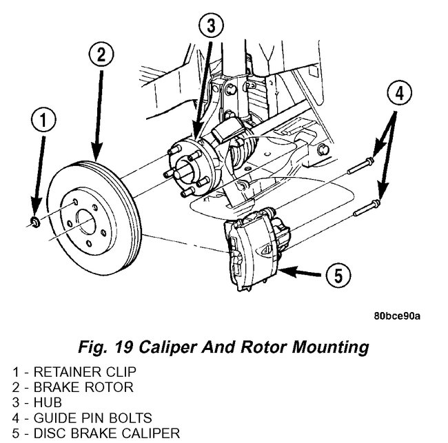

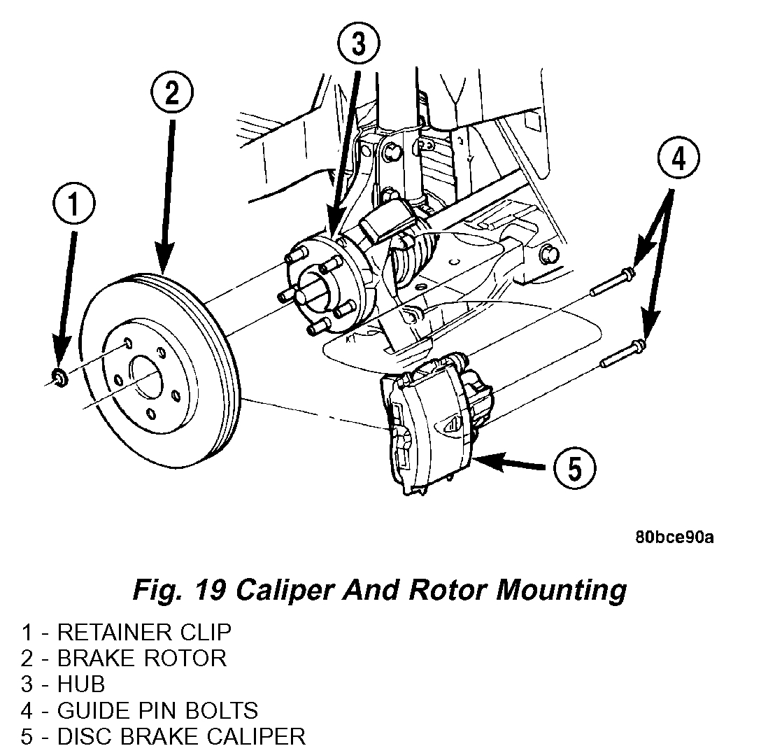

4. Remove the two brake caliper guide pin bolts (Fig. 19).
5. Remove the disc brake caliper from the steering knuckle. The caliper is removed by first tipping either the top (right side caliper) or bottom (left side caliper) of the caliper away from the brake rotor, then pulling the caliper off the opposite end's caliper slide abutment (on the knuckle) and brake rotor.

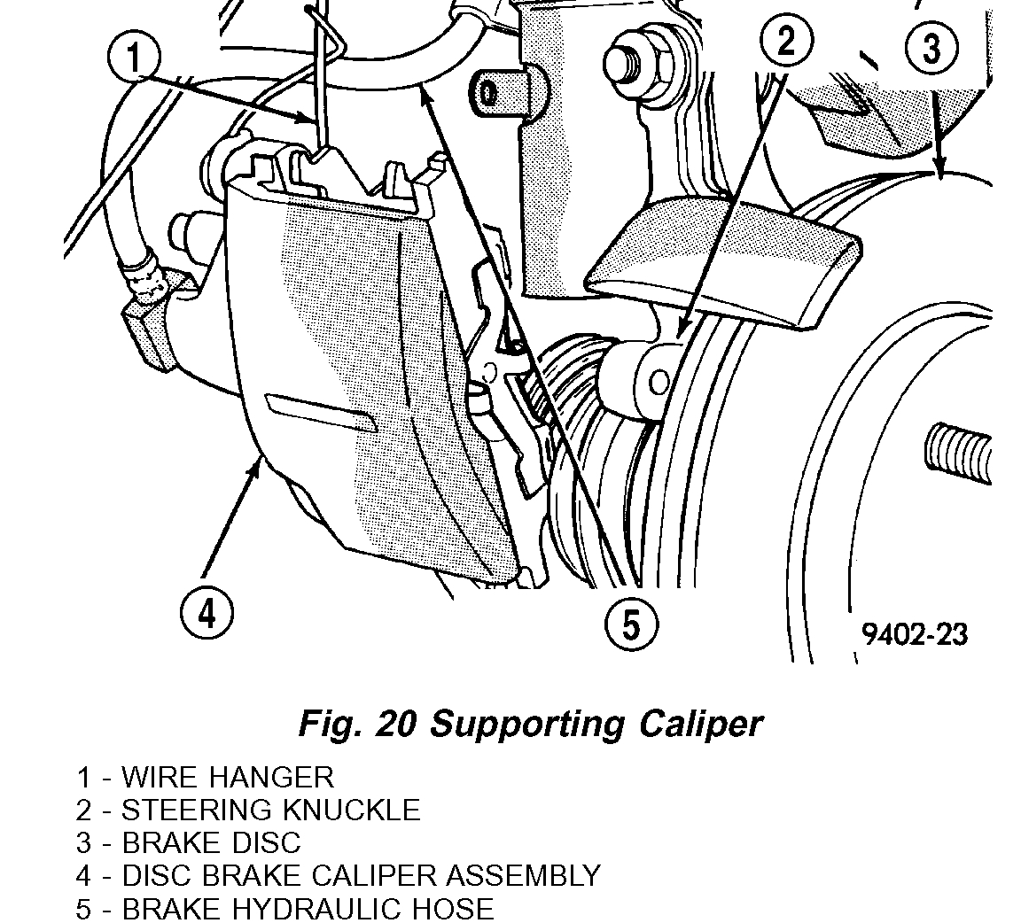

6. Support the caliper using a wire or cord to prevent the weight of caliper from damaging the brake hose (Fig. 20). Do not let the caliper hang by the brake hose.

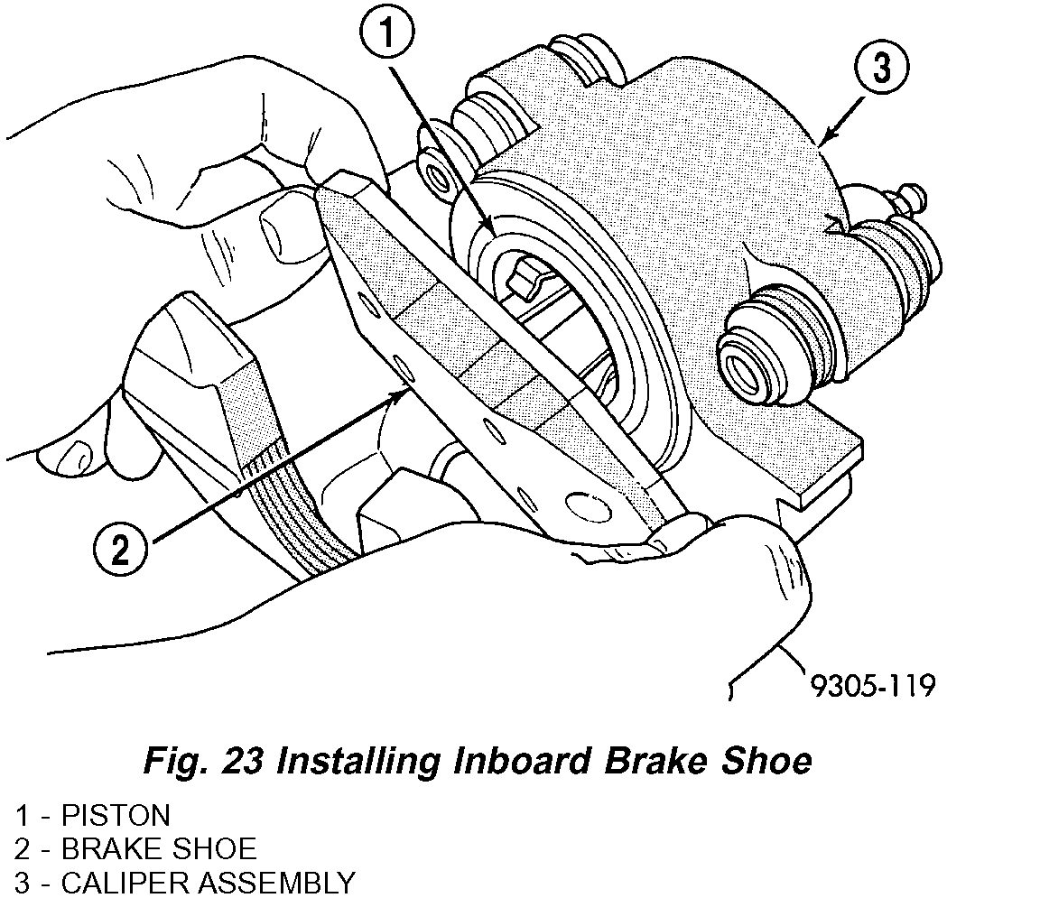

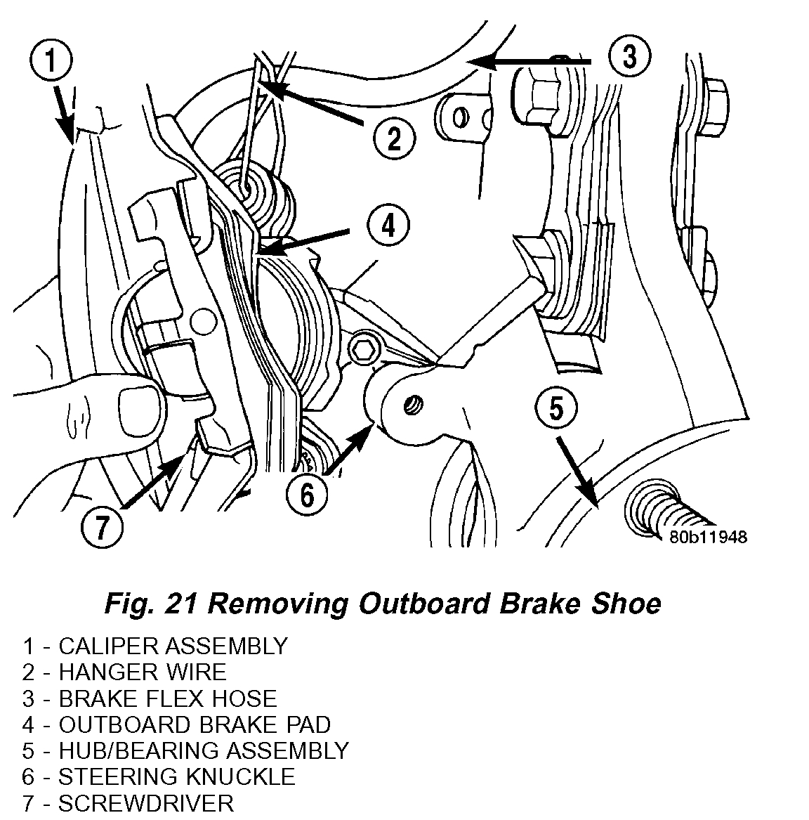

7. Remove the outboard brake shoe from the caliper by prying the shoe retaining clip over the raised area on the caliper. Slide the brake shoe down and off of the caliper (Fig. 21).
pic 4

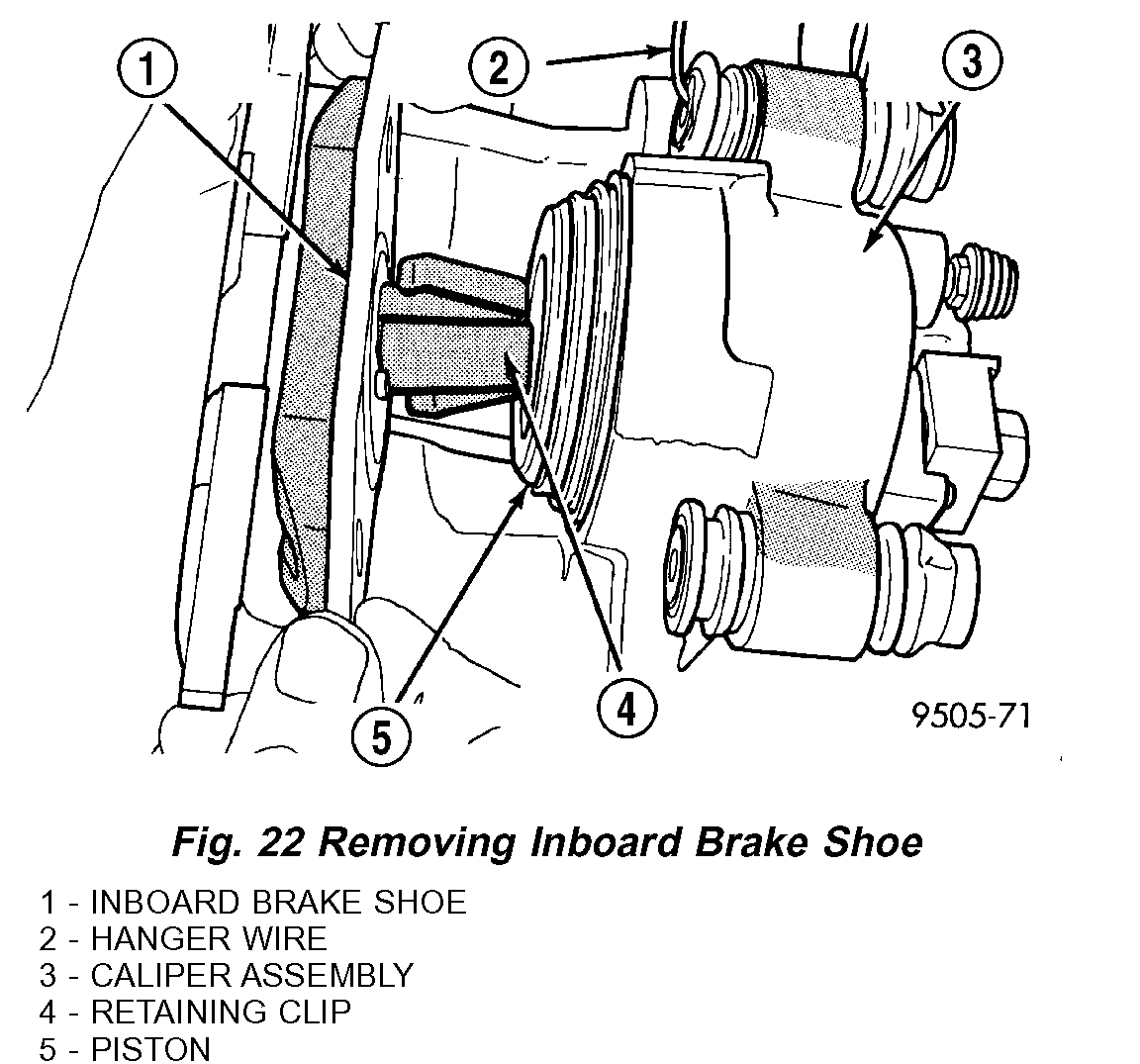

8. Pull the inboard brake shoe away from the caliper piston until the retaining clip is out of the cavity in the piston (Fig. 22) and remove the shoe.

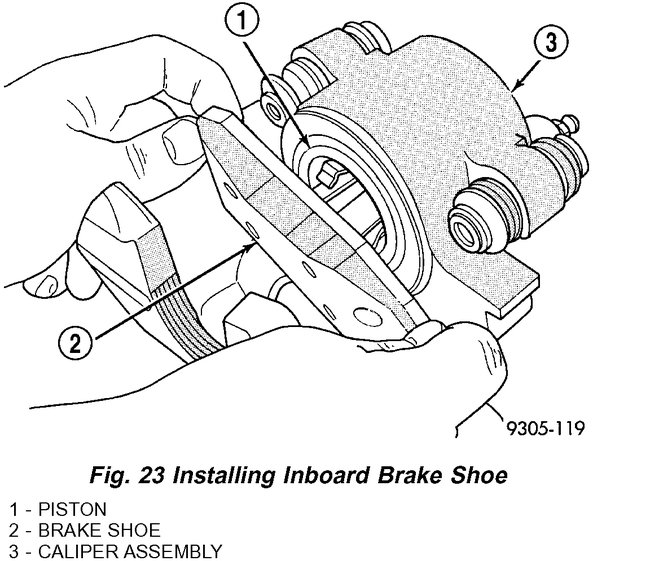

4. Install the inboard brake shoe into the caliper piston by firmly pressing the shoe in with the thumbs (Fig. 23). Be sure the inboard brake shoe is positioned squarely against the face of the caliper piston.
pic 6

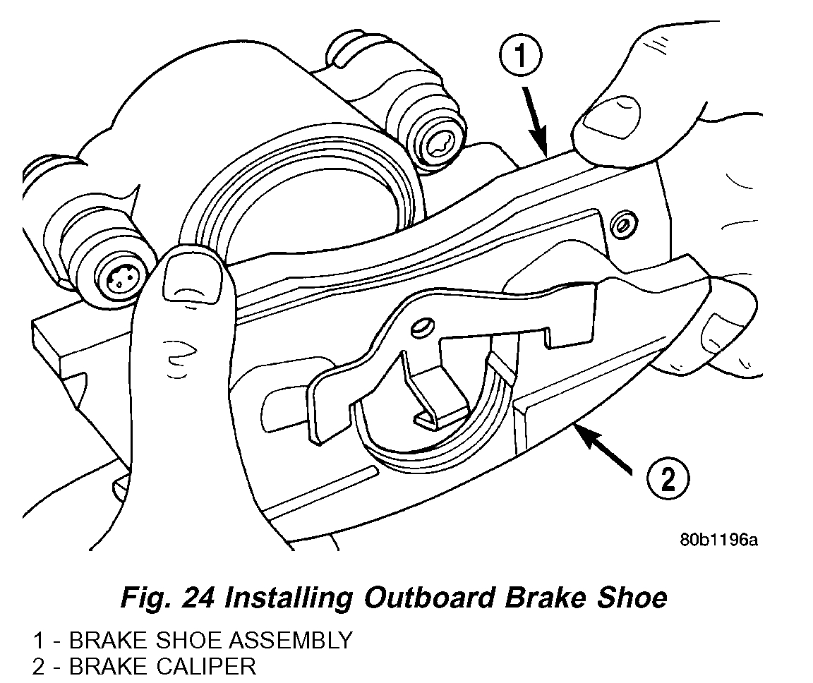

5. Slide the new outboard brake shoe onto the caliper (Fig. 24).

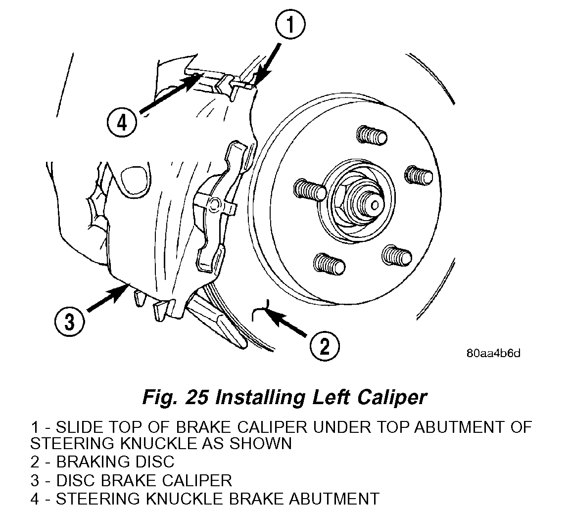

7. Install the disc brake caliper (with pads) on the brake rotor and steering knuckle. The left side caliper is installed by first sliding the top of the caliper past the top caliper slide abutment on the steering knuckle to hook the top edge of the caliper, then pushing the lower end of the caliper into place against the knuckle (Fig. 25). The right side caliper is installed by first sliding the bottom edge of the caliper past the lower caliper slide abutment on the steering knuckle to hook the lower edge of the caliper, then pushing the top of the caliper into place against the steering knuckle.
8. Install the caliper guide pin bolts and tighten them to a torque of 22 Nm (192 inch lbs.) (Fig. 19).

4. Remove the clips retaining the brake rotor (Fig. 19).
5. Remove the brake rotor by pulling it straight off the wheel mounting studs.
INSTALLATION
1. Install the brake rotor over the wheel mounting studs and onto the hub (Fig. 19).
