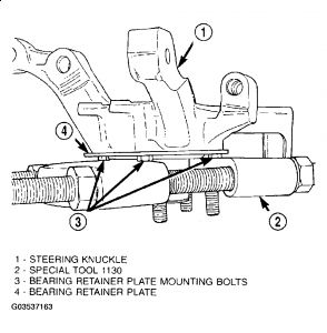

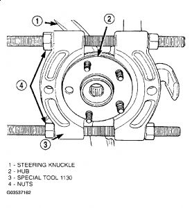

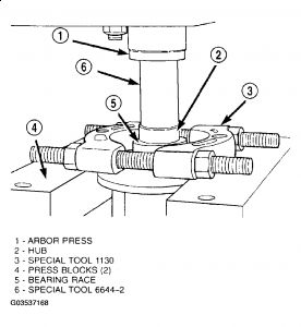

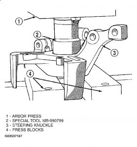

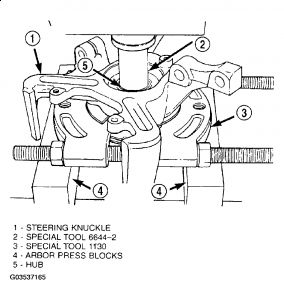

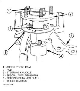

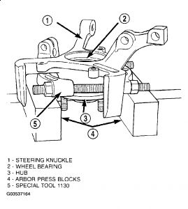

i have a 2004 dodge neon and it needs a new front drivers side wheel bearing. I got the hub off but I do not know how to get just the bearing it self off. I do not have a hydrolic press. Im trying to use a hammer and socket. In need of help bad
Wednesday, March 25th, 2009 AT 7:31 PM
BMRFIXIT
  • 19,053 POSTS
Need press and special tools
https://www.2carpros.com/forum/automotive_pictures/99387_Graphic1_277.jpg
https://www.2carpros.com/forum/automotive_pictures/99387_Graphic2_125.jpg
https://www.2carpros.com/forum/automotive_pictures/99387_Graphic3_60.jpg
https://www.2carpros.com/forum/automotive_pictures/99387_Graphic4_32.jpg
https://www.2carpros.com/forum/automotive_pictures/99387_Graphic5_18.jpg
https://www.2carpros.com/forum/automotive_pictures/99387_Graphic6_12.jpg
https://www.2carpros.com/forum/automotive_pictures/99387_Graphic7_10.jpg
