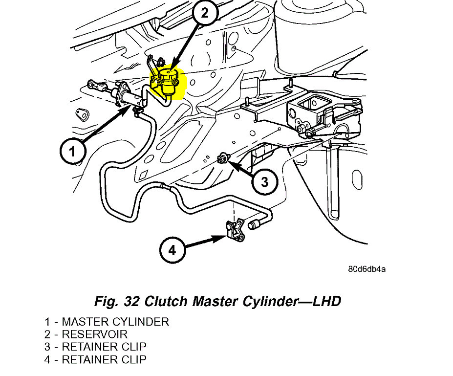

My 2004 Dodge Neon is doing this as well. When I shift gears it's sometimes hard to get it into the next gear. I sometimes have to jerk it hard to get it to go into gear. It's making a noise that reminds me of a tensioner pully going out, but it's coming from the driver's side of the motor where there are no pulleys or belts.

It sounds like the clutch isn't fully releasing. With the engine running and the vehicle in neutral and not moving, is it difficult to put it in gear? If it is, turn the engine off. Does it shift easily with the engine off?
The clutch is hydraulic on this vehicle, The clutch fluid reservoir is on the firewall under the hood, driver's side.
Check the fluid level in the reservoir. I attached a pic below of the clutch master cylinder.
Let me know if this helps and what you find.
See pic below.
