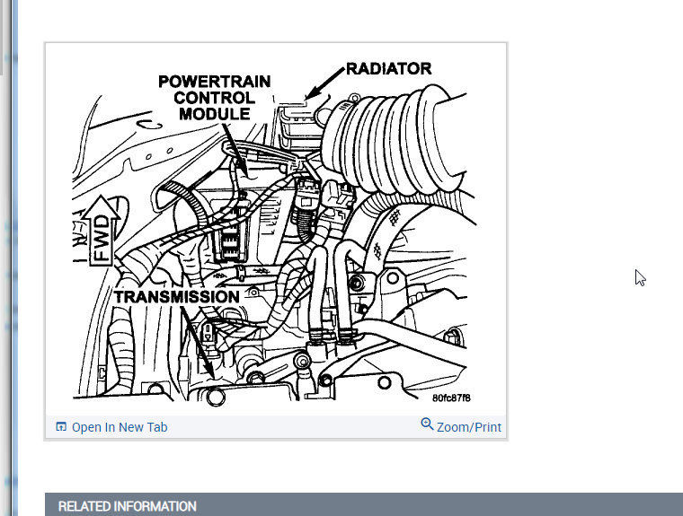

my wife was in an accident and the check engine light came right on it was the front bumper near the driver front headlight. I guess my question is depending on the location of the PCM could there be a open or short wire near this computer? because the only computer i see is below the right front headlight. any info would be good. also, i noticed her car uses a lot more gas now then before .
Jan 25, 2009 at 2:33 PM

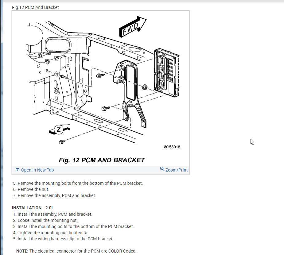

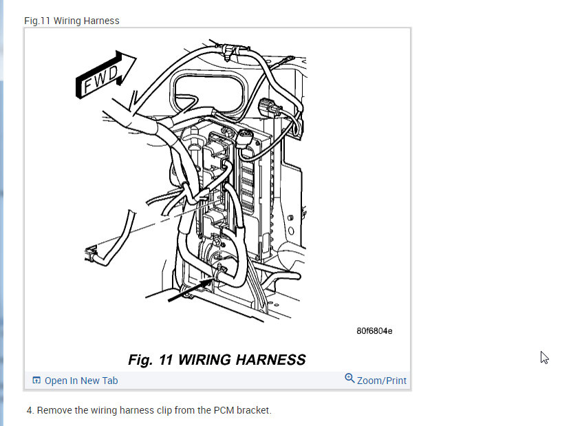

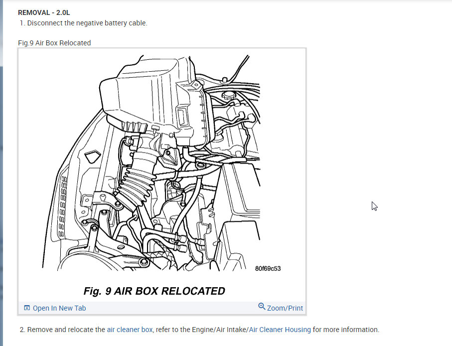

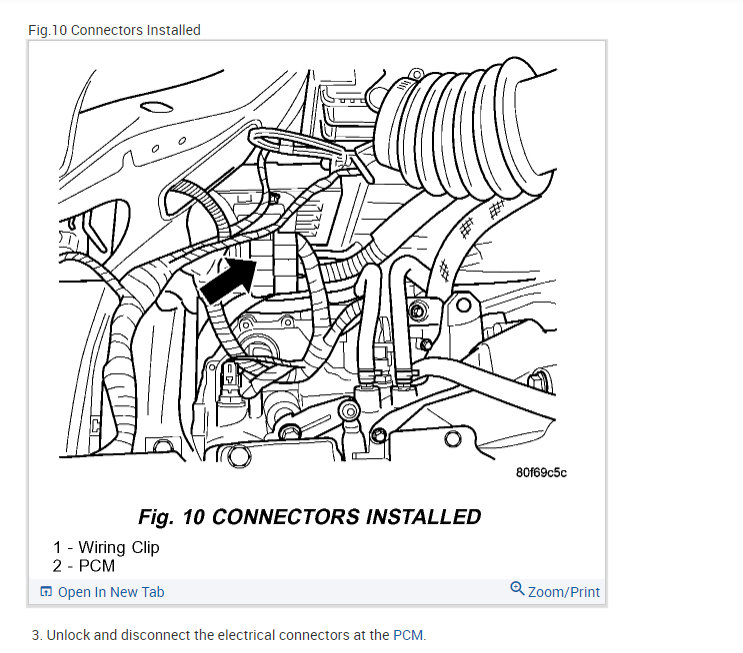

I am attaching the info that you requested. However, I suspect whatever the issue is, we have some codes. So let's start there. Here is a guide on how to check for codes:
Once we know what codes are there we will better know what damage is done. However, it is unlikely that the issue is a shorted wire as that will normally not cause a decrease in fuel mileage. There is a chance that this is the cause but we will only find it out if we pull codes for the check engine light and go from there. Thanks
