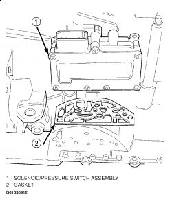

how to remove and install transmission solenoid pack

Remove input and output speed sensors. Remove three (3) solenoid/pressure switch assembly-to-case bolts. Remove solenoid/pressure switch assembly and gasket
https://images.2carpros.com/forum/automotive_pictures/99387_Graphic1_382.jpg

How do I replace the the transmission control solenoid?

If you are referring to the one that is in the front of the trans just above the trans pan, it is screwed in with either 3 or 4 bolts. Disconnect the wiring, remove the bolts, and the part will come off. NOTE: You may have to gently pry it off.
