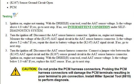

i have a 2003 dodge neon 2.0L sxt and i have this error code of P0073 so i replaced the map sensor and the air inlet sensor and still the same code , and i also tried to erase the code with an advanced auto part scan tool and still the code will not erase !!! My question is what could this be , did i miss something !!!!

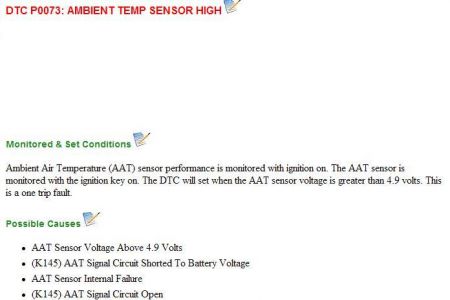

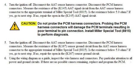

Code P0073 indicates ambient temperature sensor high. Perform following tests to diagnose problem.
https://images.2carpros.com/forum/automotive_pictures/261618_Noname_183.jpg
https://images.2carpros.com/forum/automotive_pictures/261618_Noname2_59.jpg
https://images.2carpros.com/forum/automotive_pictures/261618_Noname3_33.jpg
