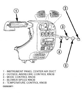

Hi! When I attempt to turn my defrost button to the defrost function, it jumps right back to the left. I have attempted to hold it in place to see if that will engage the defrost function, but that doesn't work. Please help...winter is almost here and I need the defrost. I am a poor military retiree who is desperate; but do not have the funds to seek a mechanic's help!

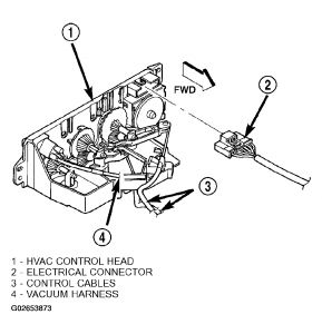

HI Mode cable maybe bent or binding. Might be able to accesss cable connection to Defrost door behind center consoule. if not center bezel will need to be removed. see diagrams
