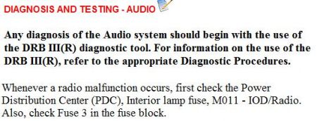

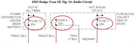

on my dodge neon 2003 i have recently replaced the battery i went to go start up the car and found out that the cd player is not working the lights forit just blink no matter what i do i cant fix the problem i tried disconnecting the battery again didnt do anything i have also checked the trouble codes and had them reset didnt do anything i was wondering if there is a reset button on it or if there is a way i can fix this if anyone has any info that could help it would be greatly appreciated thankyou

If all fuses are OK, you have to use DRBIII scan tool. Regular OBD-II scanner won't do.
