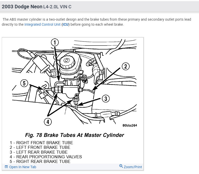

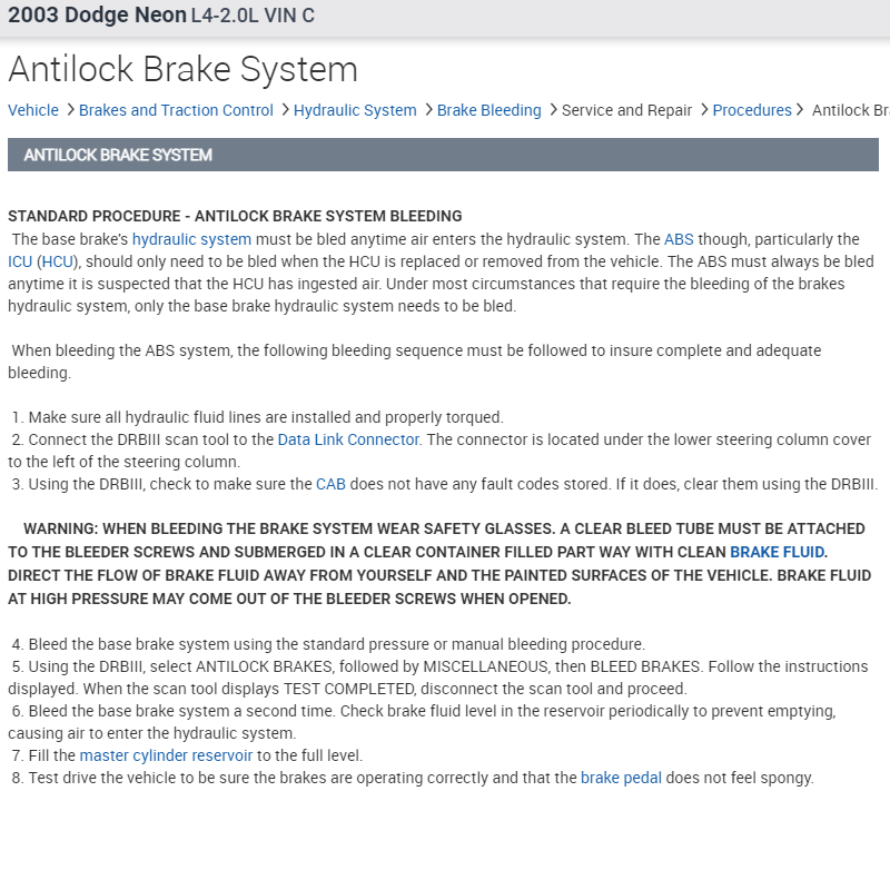

I have a 2003 Dodge Neon and tried to bleed the brakes. The car has been sitting for 2 years and the calipers were removed. I put on new calipers and tried pumping up the brakes to bleed the lines and they will not pump up.. The brake fluid canister is full.. All lines and hoses are hooked up. Any ideas why it won't pump up..
Jun 21, 2010 at 8:04 AM
SQM
  • 6,383 POSTS

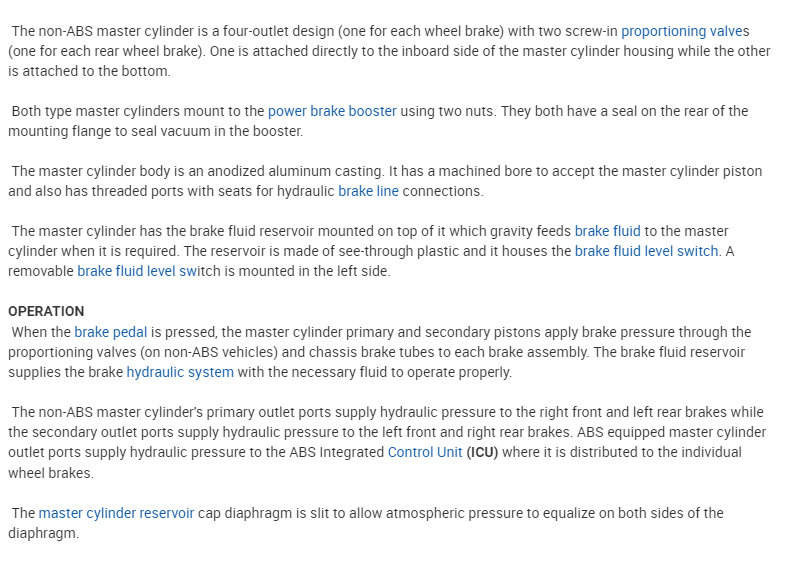

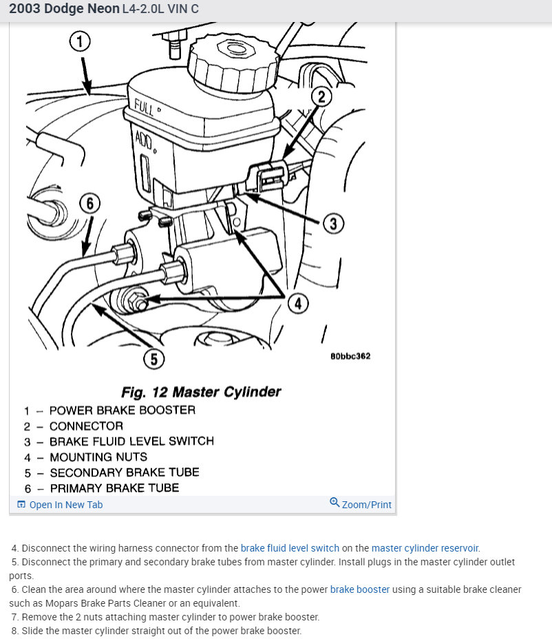

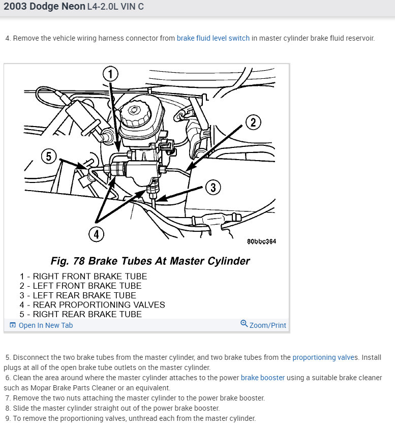

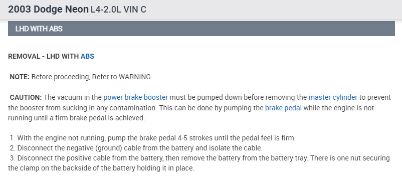

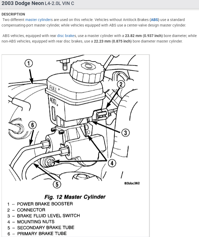

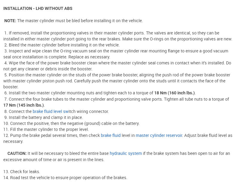

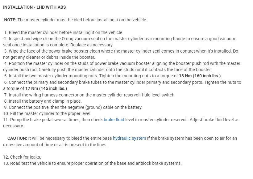

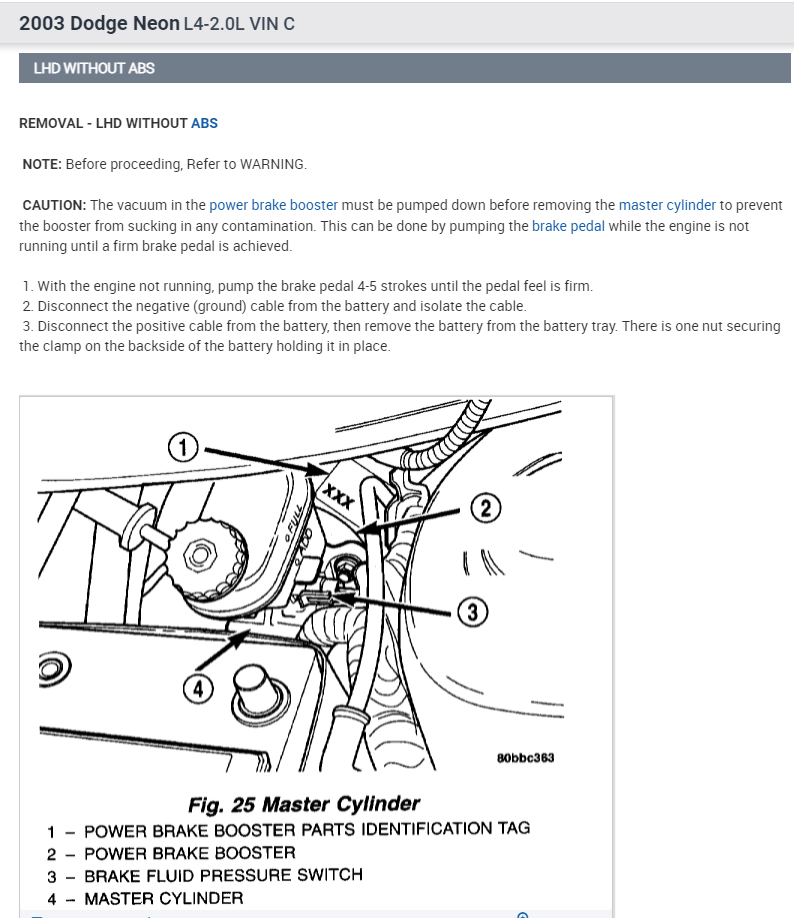

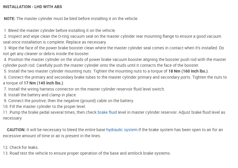

This could be due to a bad master cylinder.
If the seals inside the master cylinder are bad, then it will not build any pressure and will not bleed.

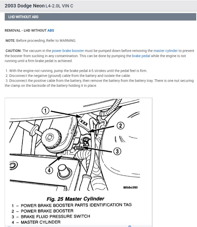

https://www.2carpros.com/articles/how-to-replace-a-brake-master-cylinder

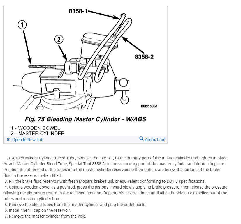

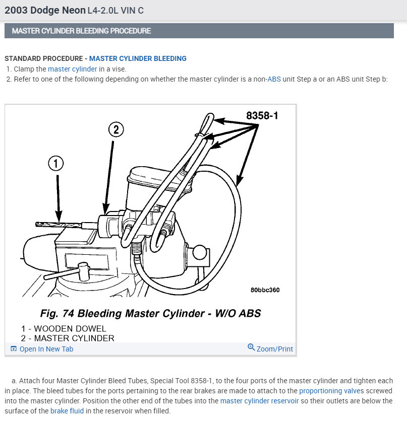

Try bleeding the master cylinder to see if you are able to.

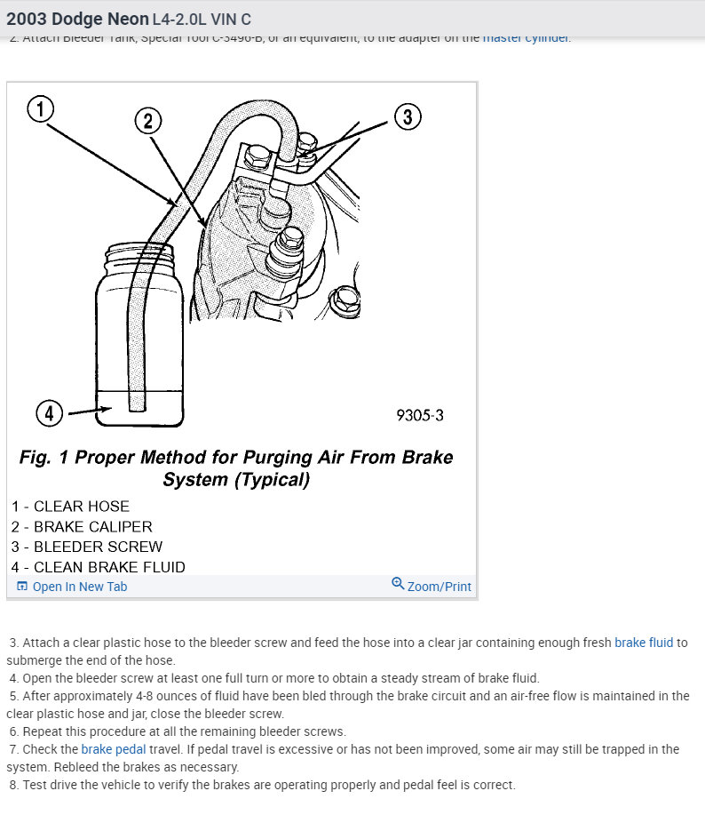

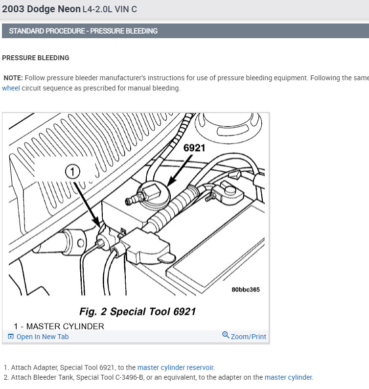

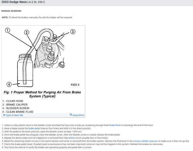

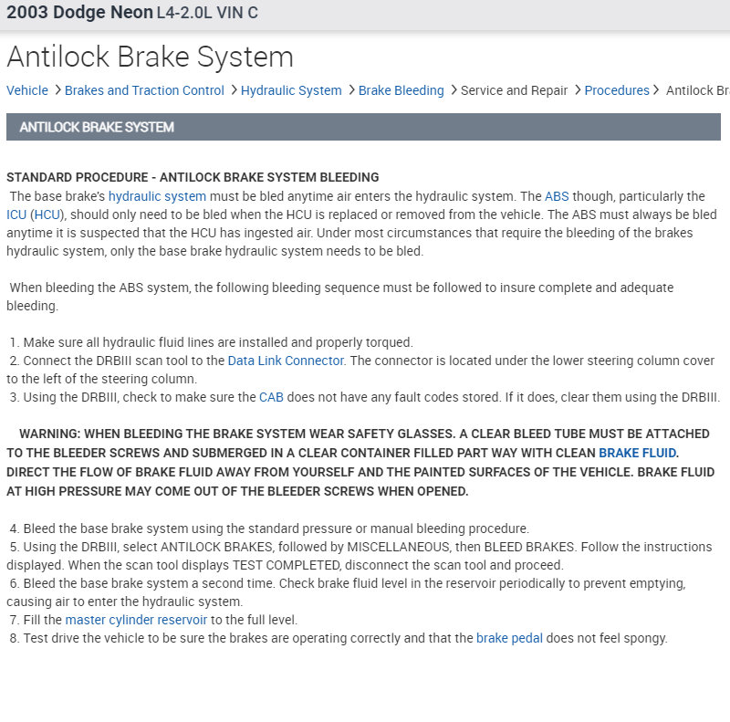

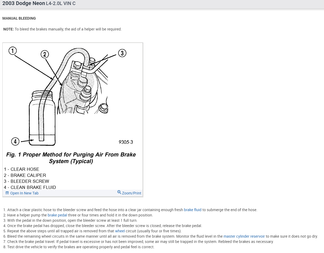

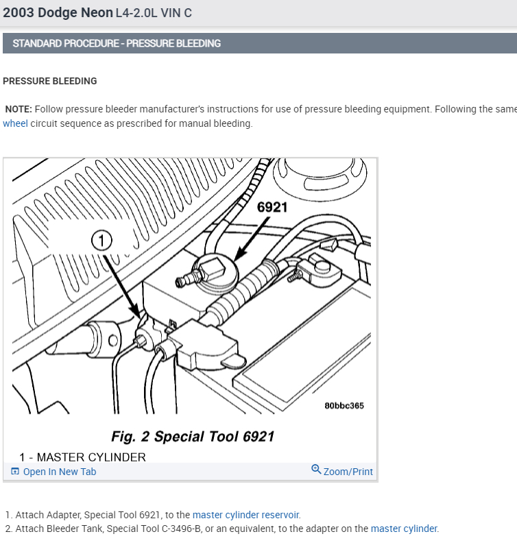

Here is a helpful guide of how to bleed the brake system:
https://www.2carpros.com/articles/how-to-bleed-or-flush-a-car-brake-system
I have attached the master cylinder bleeding as well as replacement procedure below. Also included the brake bleeding procedure for your reference.
