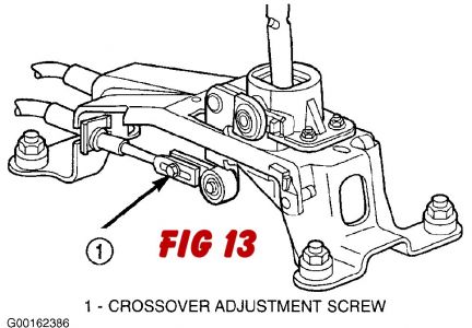

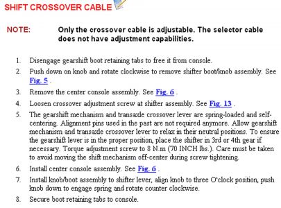

Transmission problem
2003 Dodge Neon 4 cyl Two Wheel Drive Manual
HOW DO YOU ADJUST THE MANUAL SHIFT CABLE TO CORRECTALLY ENGUAGE THE GEARS
the bushing at the transmission end came apart. replaced but not able to correctally adjust the cable to go into gear correctally

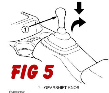

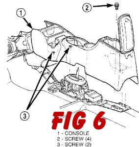

Apr 30, 2008 at 10:19 AM
SERVICE WRITER
  • 9,123 POSTS
https://images.2carpros.com/forum/automotive_pictures/30961_1fig13_1.jpg
https://images.2carpros.com/forum/automotive_pictures/30961_1fig5_1.jpg
https://images.2carpros.com/forum/automotive_pictures/30961_1fig6_1.jpg
May 1, 2008 at 10:37 PM
