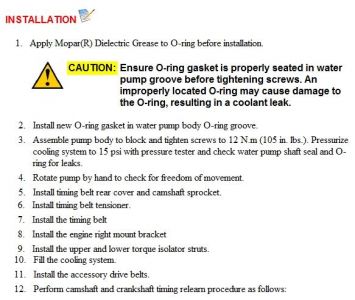

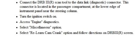

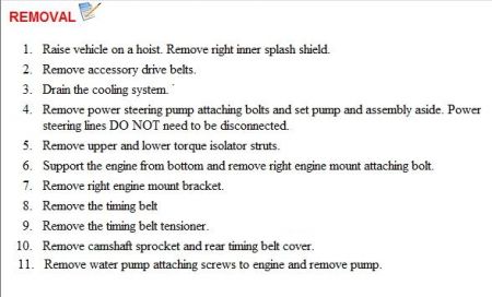

how do you take the water pump off?

https://images.2carpros.com/forum/automotive_pictures/261618_Noname_2098.jpg
https://images.2carpros.com/forum/automotive_pictures/261618_Noname2_677.jpg
https://images.2carpros.com/forum/automotive_pictures/261618_Noname3_260.jpg
