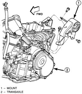

Yes Madam, there is certain specification to tightened the motor mount.
https://images.2carpros.com/forum/automotive_pictures/46384_0900c1528022303b_1.jpg

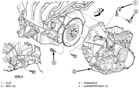

Torque the upper mount-to-transaxle bolts to 50 ft. lbs. (68 Nm). Install transaxle and tighten the transaxle-to-engine bolts, using an assistant to support the transaxle. Torque the transaxle-to-engine bolts to 70 ft. lbs. (95 Nm). Raise the engine/transaxle assembly until the upper mount aligns with the mount bracket hole. Torque the upper mount-to-mount bracket through-bolt to 80 ft. lbs. (108 Nm). Remove the jack and wooden block. the lower mount to 80 ft.Ibs Check Torque converter-to-drive plate bolts and torque the bolts to 65 ft. lbs. (88 Nm) If one or some of those bolts get lose, vibration will occur. How is the transmission fluid level?
https://images.2carpros.com/forum/automotive_pictures/46384_0900c1528022303a_2.jpg
Check torque converter bolt to flywheel. Get back after you check those.
