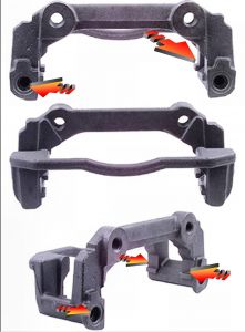

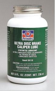

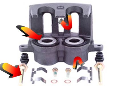

Brakes problem 2002 Dodge Neon 4 cyl Wheel Drive Type unknown Automatic 94546 miles ---------------------------------------------------------------- my ? to u is that whenever I hit the brakes it squeaks. why? Can u please help me
Jan 10, 2008 at 8:03 PM
SERVICE WRITER
  • CAR REPAIR CONTRIBUTOR
  • 9,123 POSTS
Neons are brutal like that. Try a softer pad and be sure all needed areas a cleaned and lubed.
