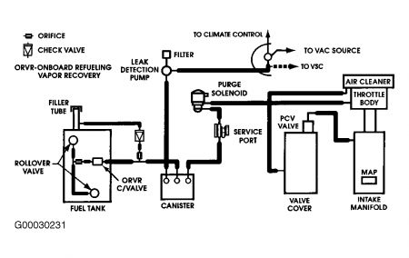

When stop the car shakes alot. When I increase speed it stops. however for the past two weeks i have notice that the car is having trouble speeding up. Also I cannot fill up the gas tank. I full up but when I get in the car i see that it does not mark the tank as being full (almost but not). Also I feel that the car is using up more gas. The car has all four new tires (3 months ago). Last month the spark plugs were changed and the fuel system was serviced. Should i try a fuel injector cleaner?

You have problem with your EVAP emission system. Follow this diagram and check every component of the system. Keep a closer eye on the purge solenoid valve, check valve, and the canister; for clogging, cracks, and/or general operations.
https://images.2carpros.com/forum/automotive_pictures/55316_02neonvacuum_1.jpg
