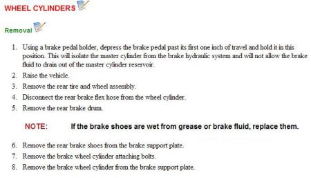

2002 Dodge Neon fluid leaking from right rear drum

would this be cylinder issue, and where do i find info on how to repair it

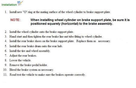

inspect the brake hoses to ensure none are damaged and leaking. if OK then suspect faulty wheel cylinder. replacement instructions are below..
