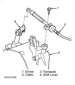

My dodge neon would be parked, and I would insert the key, turn the key, ALL LIGHTS come on, turn the key but silence follows,...
I have to literatelly HIT THE SHIFT in PARK and then the car can be started without any problems...
any ideas?

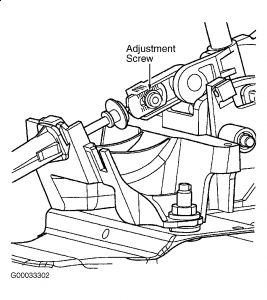

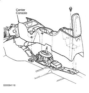

Shifter link out of adjustment check and adjust shifter cable
