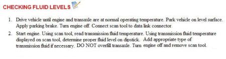

can ya tell me how to check the transmissons fluid on the car

https://images.2carpros.com/forum/automotive_pictures/261618_Noname_1082.jpg
