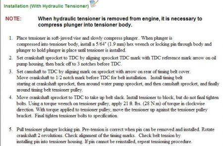

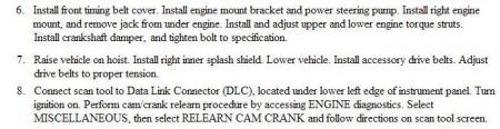

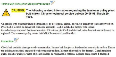

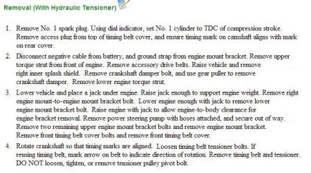

Having trouble getting brackets out of way to get to timing belt. Any suggestions how to get them off thanks much
