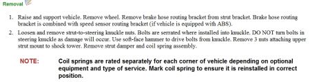

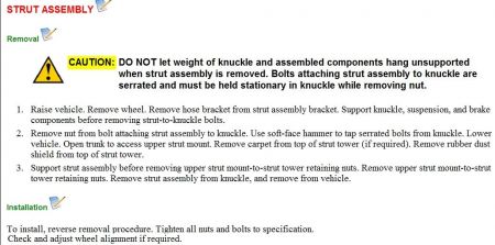

Do you have any tutorial videos on here to guide someone through replacing their own shocks and strus?
Nov 7, 2010 at 12:23 AM
BLUELIGHTNIN6
  • 16,542 POSTS
no video on this just yet, sorry. but here are the proper replacement steps for your vehicle's front and rear struts/shocks..
https://images.2carpros.com/forum/automotive_pictures/261618_Noname_2890.jpg
https://images.2carpros.com/forum/automotive_pictures/261618_Noname2_951.jpg
https://images.2carpros.com/forum/automotive_pictures/261618_Noname3_341.jpg
