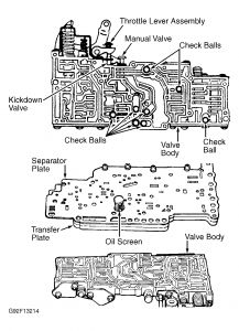

I recently changed the solenoid in my 2000 dodge neon, it has a 2.0 liter engine. I had to drop the transmission pan, take the filter of and remove the lower part of the valve body. Once inside i noticed some small ball bearings inside. They just rolled off onto the matt. my question is: how do i get a diagram to show exactly where these ball bearings go on the valve body. i had put them back in but obviously i must have done it wrong. Because the car won't shift into reverse now nor will it shift out of second. If you could help me solve this problem i will be forever greatly appreciative.

Check ball locations see diagram use Vasoline to hold in place
https://images.2carpros.com/forum/automotive_pictures/198357_Graphic_614.jpg

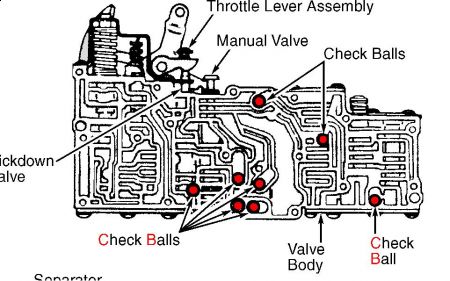

I need to know where in the valve body the bearings are to be seated. I seperated the valve body and the barings fell out. Can you please help?

https://images.2carpros.com/forum/automotive_pictures/99387_Graphic1_374.jpg
https://images.2carpros.com/forum/automotive_pictures/99387_ball_1.jpg
if can not see clear let me know i will try to email it 2 you good luck
