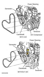

2000 Dodge Neon automatic belt tensioner between power stee
2000 DODGE NEON
113,000 MILES • 4 CYL • 2WD • AUTOMATIC
PINEJB
My manual says: simply remove the bolt at the pivot point and remove the tensioner. First, there is no bolt at the pivot point...there is a hole. It may take an allen wrench but it's so tight in the engine compartment you can't see to tell. But even if it did take an allen wrench, there's no room to get one in the hole...there's about an inch or less clearance. There just seems like no way to gety this dang thing off. Maybe you need a special tool? Help!

Of course you need A special tool you can try and use socket holder (ratchet) its a square in the mid of the tensioner need manual CHECK IT @ https://www.2carpros.com/kpages/auto_repair_manuals.htm
https://images.2carpros.com/forum/automotive_pictures/99387_neon_2.jpg
