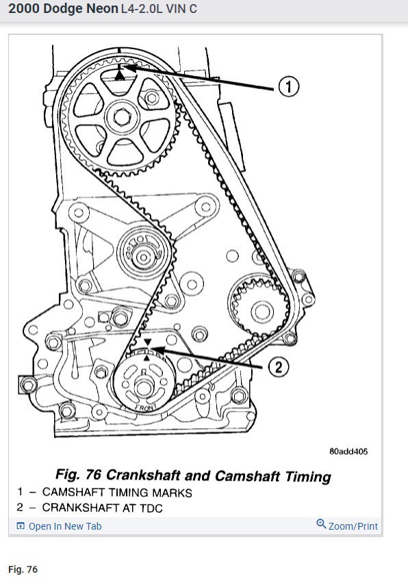

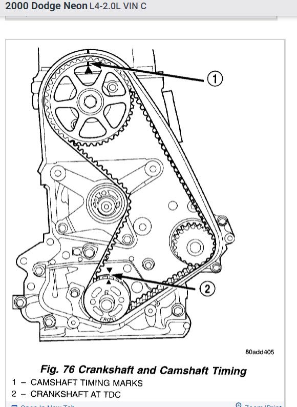

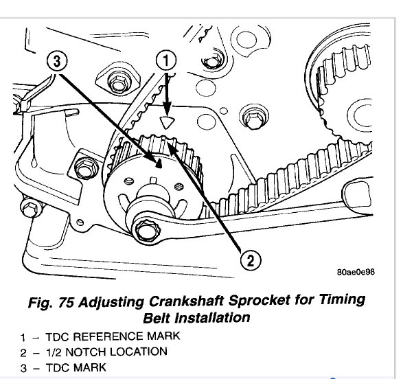

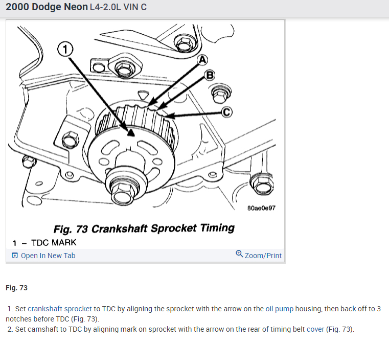

just replaced timing belt timing lines up on crank and cam car starts just fine then starts missing. So ckecking with timing light timing is one tooth below TDC. checked plugs,wires,vacume
Oct 23, 2010 at 11:05 AM
SQM
  • 6,383 POSTS
A timing belt synchronizes the rotation of the crankshaft and the camshaft(s). This makes the engine valves open and close at the proper time during the engine operation.
So if the timing is off by a little it can severely affect the engine.

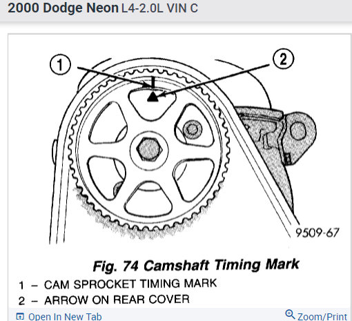

The timing mark should be at TDC this vehicle.
So you will have to adjust it and make it at TDC.
You might find this article helpful:
https://www.2carpros.com/articles/how-a-timing-belt-works

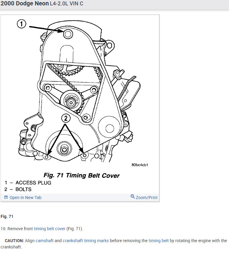

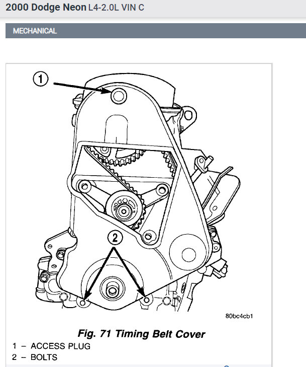

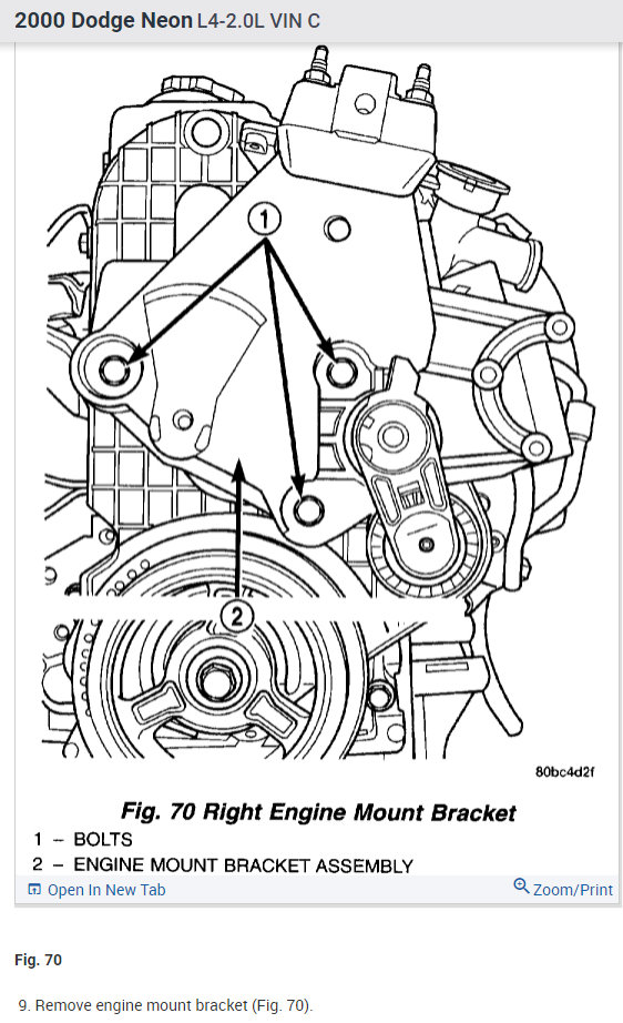

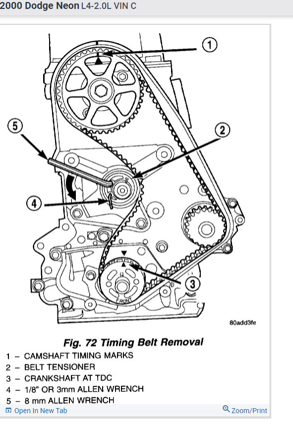

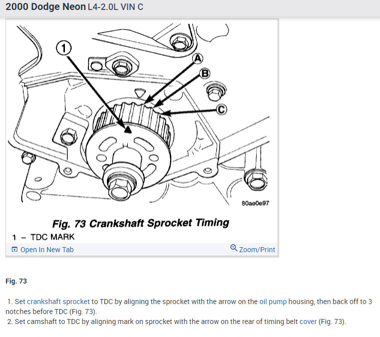

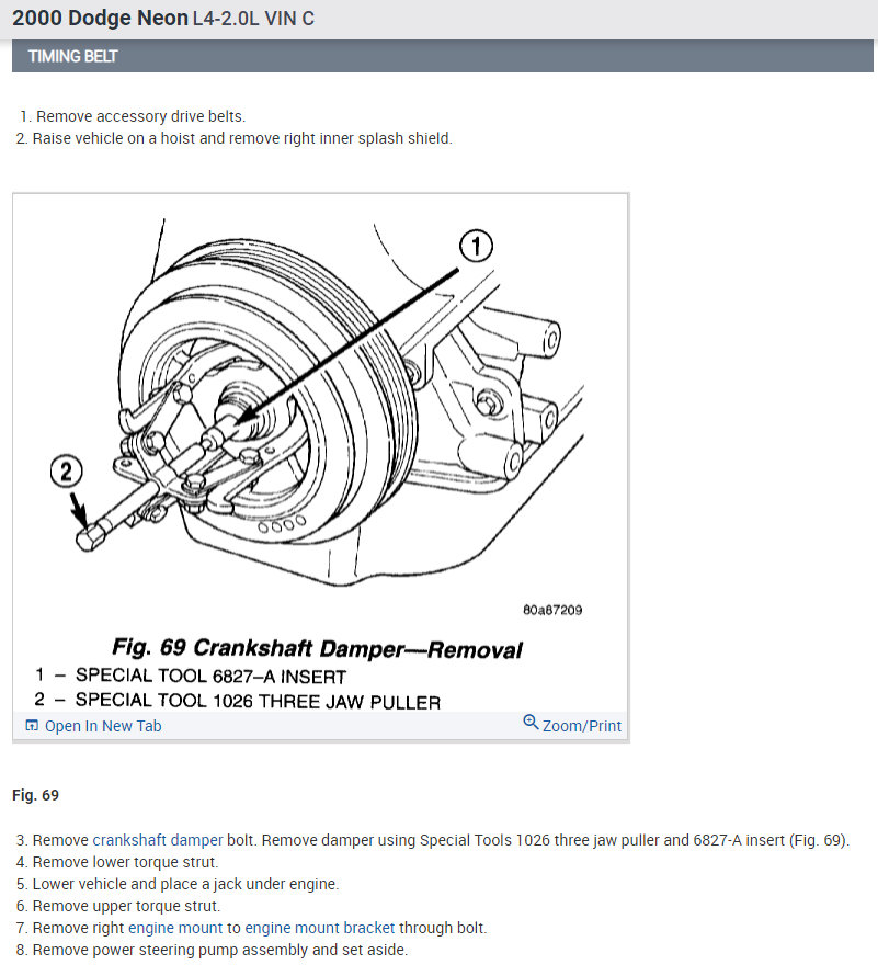

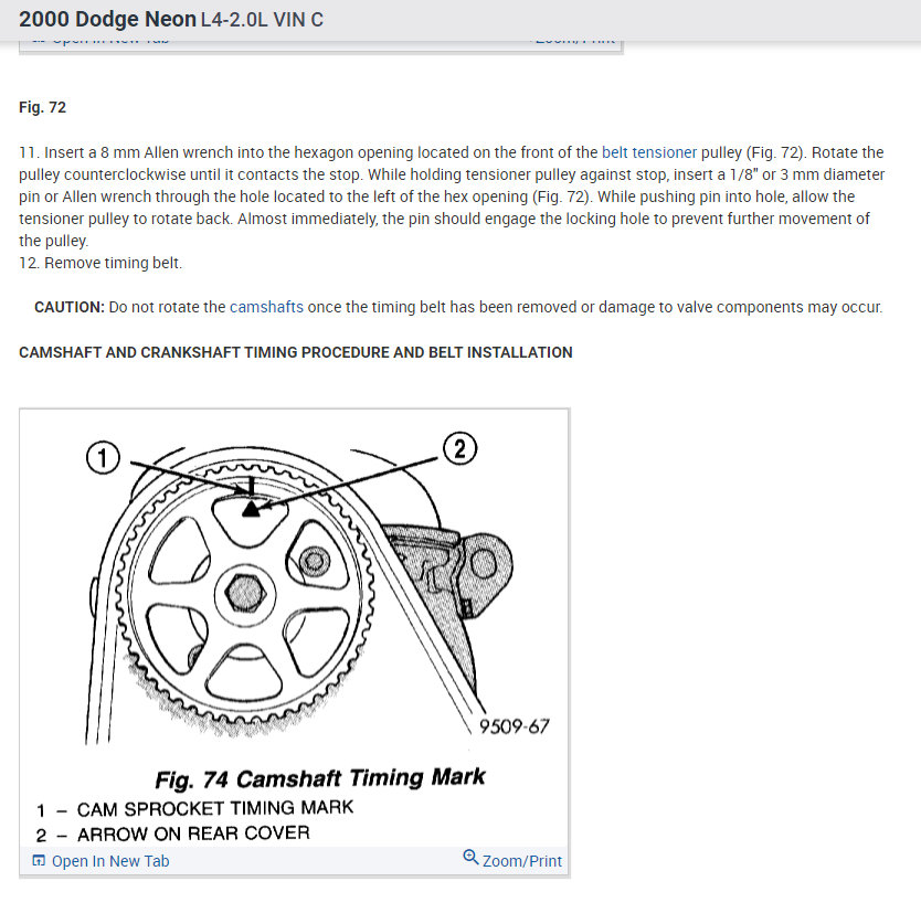

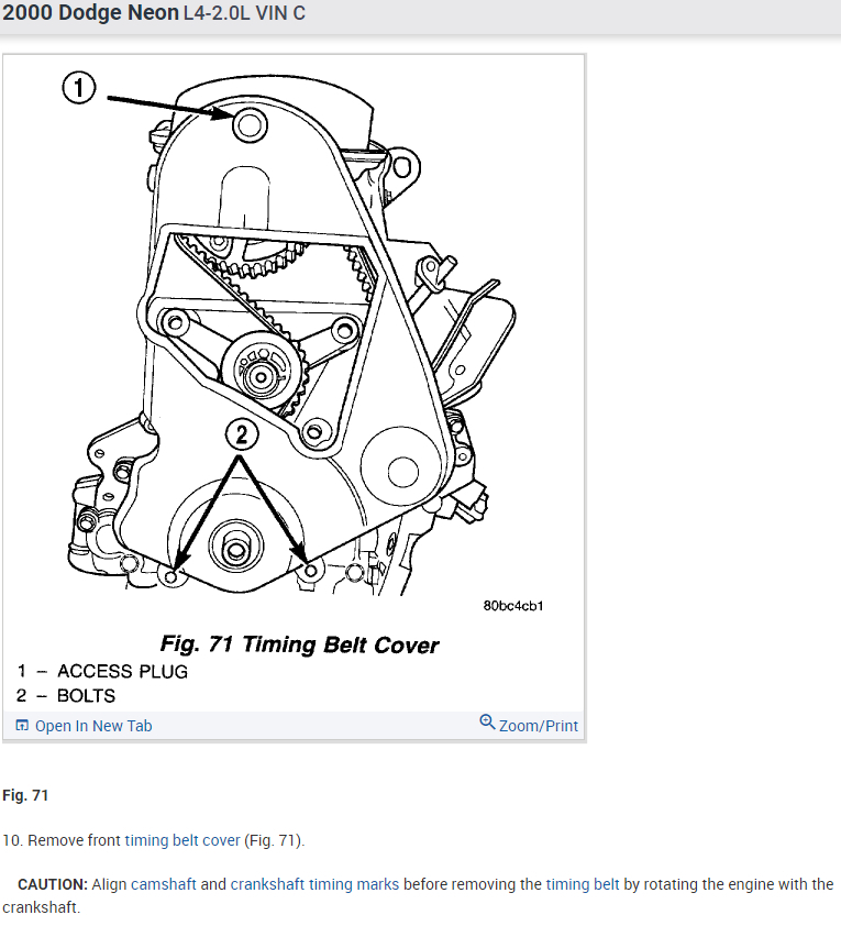

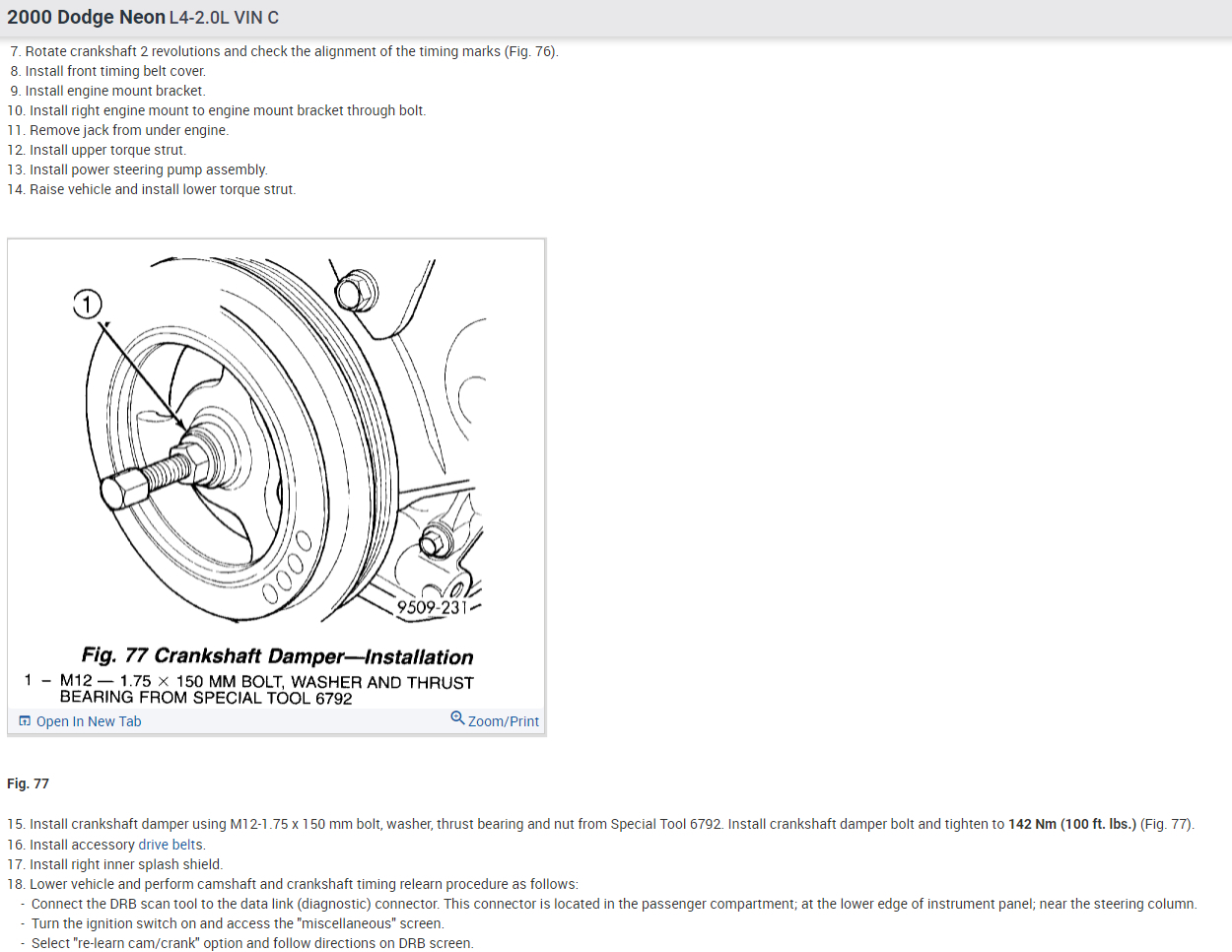

I have attached replacement procedure for your reference.
