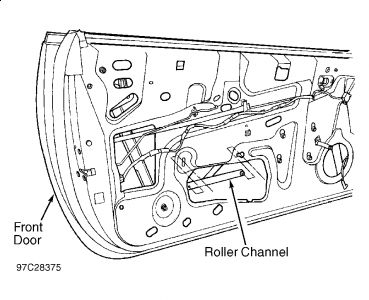

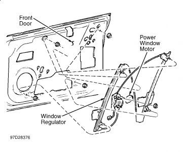

i have a new window crank assembly but its for a 2000 and the one im tryin to fix is a 99 im sure it will work. i just need some blue prints of the door assembly to know that im doing it right and i cant find them any where, any ideas? cuz its hard to work my long skinny arms up in side that door without knowing where things go... by the way its a 4 door thanks chrys AKA SKINNEY

Open door. Lower door glass. Remove door pull cup. While pulling door release handle, remove screw securing trim panel to door from behind inside door release handle. Disengage hidden clips securing trim panel to door from around perimeter of panel. Tilt trim panel outward to clear locator pins on backside of trim panel. Disengage trim panel from retainer channel at top of door. Move trim panel away from door and disengage clip holding door latch linkage to back of inside door handle. Separate latch rod from handle. Disconnect harness connectors for power door lock switch, mirror switch and power window switch
