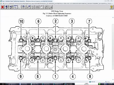

original problem, leaking oil from the back right corner below the head gasket. Went in replaced the head gasket , car wouldn't start but saw antifreeze in oil. crap, tore down again checked head and had resurfaced, replaced head gasket/bolts. Car runs but still has antifreeze getting in the oil. Have torn down a third time and had the head pressure checked and flatness checked, flatness checked the block, Mechanic at the shop said he didn't see anysigns of failure in the head gasket? What could it be?

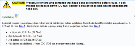

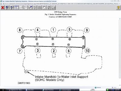

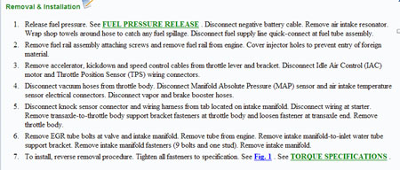

https://images.2carpros.com/forum/automotive_pictures/62217_Head1_1.jpg
https://images.2carpros.com/forum/automotive_pictures/62217_Head2_1.jpg
https://images.2carpros.com/forum/automotive_pictures/62217_Intake1_1.jpg
https://images.2carpros.com/forum/automotive_pictures/62217_Intake2_1.jpg
Bolts 7, 8, 9, 10 Are the SHORT bolts! Get all new bolts, they may have lost sealing and gripping ability!

Merlin may have hit it with the long/short bolt idea. No sealing power if the bolt is bottomed out
Mar 12, 2008 at 12:42 AM
PEDALTHERE
  • 5 POSTS
no, the bolts were new and the short bolts were in the corners, There's at least 3 inches difference, you wouldn't be able to make that mistake.

if im not mistaken pressure checking the head might not show a crack , magnafluxing will though , also it could be an intake gasket leak
