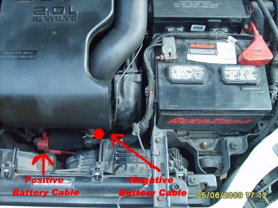

the ground wire came undone. one end is still attached to the battery, where does the other end go?

Included is a picture of where my ground wire is attached (red line). Where the hood meets the body.

thanks but i have 2 wires coming off the negative post...the one you showed me is still attached. can u tell me where the other wire goes?

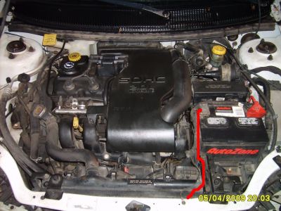

Unless you find the answer sooner, I can look at the Neon in a few hours to give you the exact location, I`m not the person who drives it.
Found this answer on the web:
"The negative cable almost always goes to the engine block then it has a strap that grounds the block to the frame and body. There could be several of these "straps" or wires. They usually look like a braided metal rope except flattened out."

Ground wire is where the red dot is. Behind and to the right of the starter. Bolts on the block.

THANKS SOO MUCH FOR YOUR HELP!

There should be a bolt in the block where it would connect unless the bolt has dropped out.
