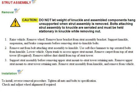

does anyone have a diagram for a 1998 dodge neon rear struts. i need to know how to replace them. and a diagram would be much appreciated. or you can verbally tell me how to do it. is it just simply jacking up the car and replacing them. or do you need to remove things to get at the rear struts. thank you for your help??

https://images.2carpros.com/forum/automotive_pictures/261618_Noname_1648.jpg
