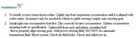

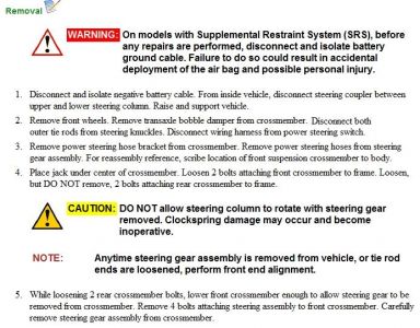

how to take and put back together??
Apr 30, 2010 at 6:42 AM
BLUELIGHTNIN6
  • 16,542 POSTS
https://images.2carpros.com/forum/automotive_pictures/261618_Noname_2083.jpg
https://images.2carpros.com/forum/automotive_pictures/261618_Noname2_674.jpg
