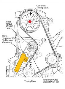

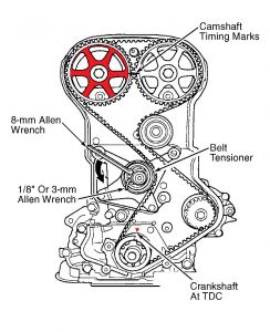

I have a 98 plymouth neon,which i just put a brand new timing and water pump in it. It starts bt it putters and acts like it wants to turn of bt stays running until i put it in drive or reverse then it will stahl and i have to start it again. As long as i get going it works just fine bt if it idles too long or i am driving to slow it will stahl again and i have to keep restarting it.And when i have to start it sometimes i have to press down on the gas a little bit for it to start. Whats wrong with my car?

Check timing marks
check timing
did you have that problem prior to the timing belt ?

Nope i had no trouble prior to the timing going out.

which engine you have check timing marks and do a compression test good luck
https://images.2carpros.com/forum/automotive_pictures/99387_neon_dohc_1.jpg
https://images.2carpros.com/forum/automotive_pictures/99387_neon_sohc_1.jpg
