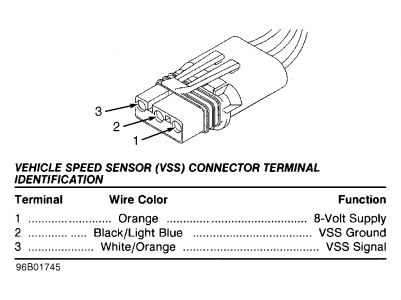

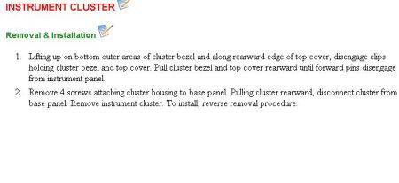

my speedometer works sometimes and sometimes not. All other gauges work fine. Also I do not know how to get the gauge package (unit) out of the dash.
Feb 24, 2009 at 8:00 AM
ZACKMAN
  • 4,202 POSTS

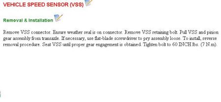

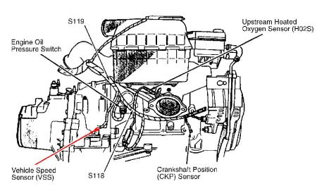

Your speedometer operation is controlled by the vehicle speed sensor. Looks like you are getting intermittent problem from the sensor.
