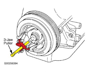

When you say three prong pull does this thing have arms and hook around the outside of balancer?
If so wrong puller you need an harmonic puller it bolts to balancer in those bolt holes in the center. Auto Zone can rent , you will never get it off with a bearing puller.

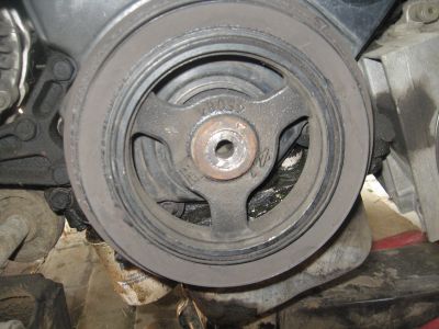

20DORY20
  • 5 POSTS
Yea we are using a 3 jaw puller, the only problem is the pulley doesn't have bolt holes.

https://images.2carpros.com/forum/automotive_pictures/99387_puller_chry_2.jpg

20DORY20
  • 5 POSTS
Thats exactly what we have and how we r doing it. Thanks

20DORY20
  • 5 POSTS
we may have to try heating up the balancer

BMRFIXIT
  • 19,053 POSTS
are using a rod in the center check the picture I sent it has a rod in where the center bolt was removed
and it longer then the bolt that was removed
