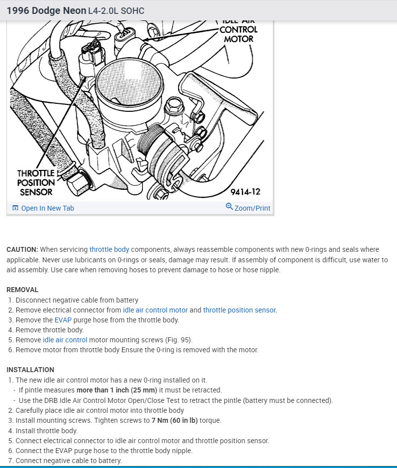

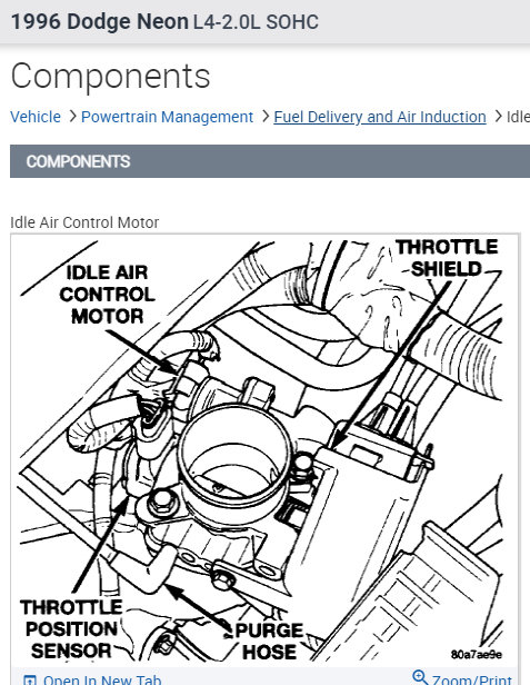

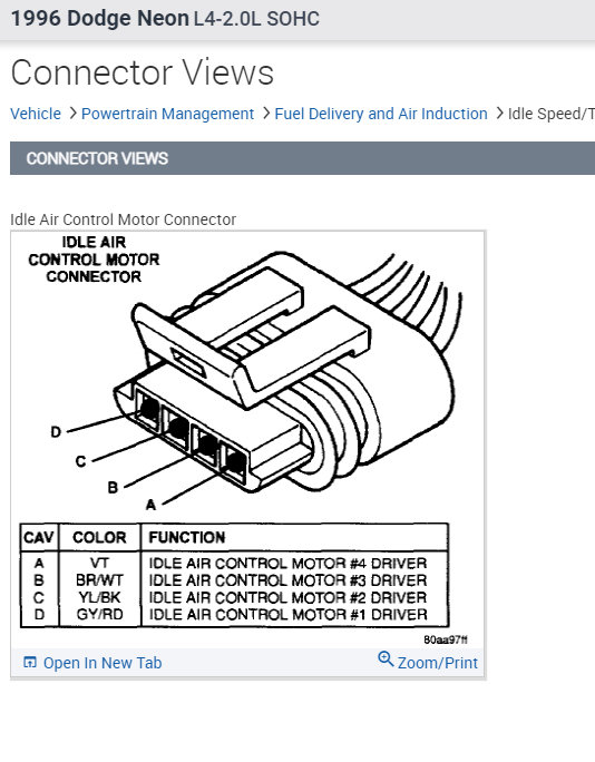

I have a 1996 Dodge Neon Highline (SOHC) and it will run fine as long as I have my foot on the gas, but it idle it will just die, it doe not sputter or anything just dies, My check engine light had been on and it was giving a code for the o2 sensor and I replaced that but I am still having the same Idle problem, what could be causing this?
