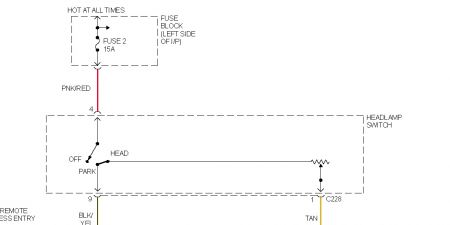

Dash lights won't come on.
Thursday, November 4th, 2010 AT 11:12 AM
JDL
MECHANIC
16,098 POSTS
Use a voltage tester, check applicable fuse, also check voltage at the fuse. If there is dimmer at the headlamp switch, if rotated all the way down, may not be any dash lites?
