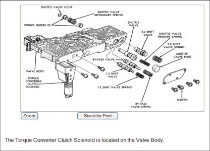

Next we are trying to make the connection ourselves about it dying in forward but not in reverse. I think you will agree, if a module is heating up it will heat up in drive just like it will in reverse. Also, if a converter is locking up it will possible make a noise or something in reverse or possible throw codes etc. So when we are asking certain questions it is to find the correlation between them all plus, some of the manuals we review ask the same questions during the troubleshooting that we are asking. This way we can get through many of the steps quicker to get you the results you need.
